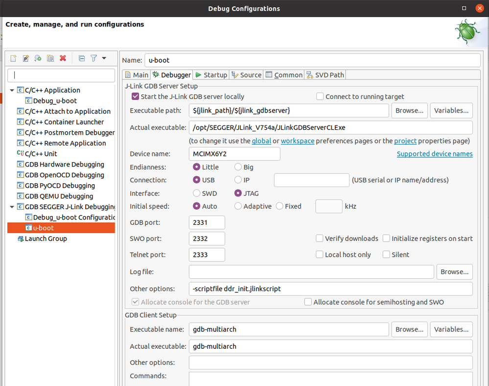

Hello.
Trying to debug U-boot on IMX6ULL using this manual.
So I am able to compile U-boot sources using Eclipse and get binary U-boot file.
Enabled debugging options in .config file:
CONFIG_CC_OPTIMIZE_FOR_SIZE=n
CONFIG_TOOLS_DEBUG=y

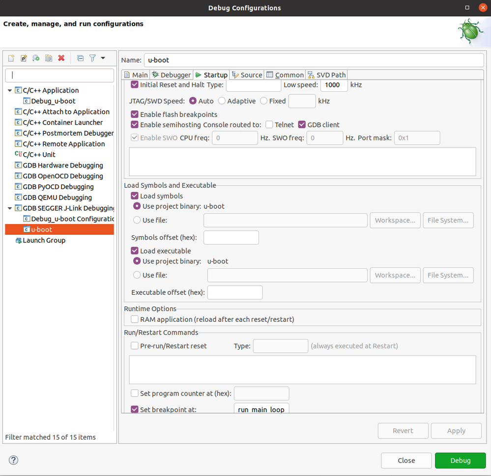

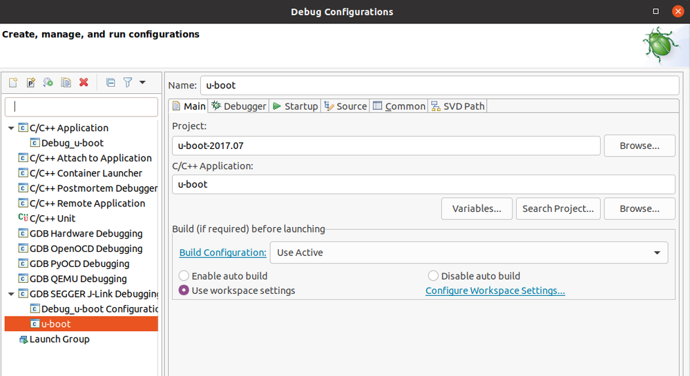

Here debugger configuration:
Screenshot from 2021-09-08 23-29-07.pngScreenshot from 2021-09-08 23-29-07.png
Screenshot from 2021-09-08 23-29-27.pngScreenshot from 2021-09-08 23-29-27.png
Screenshot from 2021-09-08 23-29-46.pngScreenshot from 2021-09-08 23-29-46.png

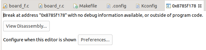

Everything looks fine but unfortunately get following error message at debugging window:
Screenshot from 2021-09-08 23-27-17.pngScreenshot from 2021-09-08 23-27-17.png
Another one thing confusing me is that u-boot console still accessible to enter commands and no reboot messages in console during startng debugging session.
Any hints what did I miss?

then I created gdb init script based on lauterbach's dcd files and script provided there:
# Initializing target
target remote localhost:2331
monitor reset
monitor halt
monitor sleep 200
# Disable Watchdog
monitor memU32 0x020bc000=0x30
# Enable all clocks
monitor memU32 0x020c4068=0xffffffff
monitor memU32 0x020c406c=0xffffffff
monitor memU32 0x020c4070=0xffffffff
monitor memU32 0x020c4074=0xffffffff
monitor memU32 0x020c4078=0xffffffff
monitor memU32 0x020c407c=0xffffffff
monitor memU32 0x020c4080=0xffffffff
monitor memU32 0x020E04B4=0x000C0000
monitor memU32 0x020E04AC=0x00000000
monitor memU32 0x020E027C=0x00000030
monitor memU32 0x020E0250=0x00000030
monitor memU32 0x020E024C=0x00000030
monitor memU32 0x020E0490=0x00000030
monitor memU32 0x020E0288=0x000C0030
monitor memU32 0x020E0270=0x00000000
monitor memU32 0x020E0260=0x00000030
monitor memU32 0x020E0264=0x00000030
monitor memU32 0x020E04A0=0x00000030
monitor memU32 0x020E0494=0x00020000
monitor memU32 0x020E0280=0x00000030
monitor memU32 0x020E0284=0x00000030
monitor memU32 0x020E04B0=0x00020000
monitor memU32 0x020E0498=0x00000030
monitor memU32 0x020E04A4=0x00000030
monitor memU32 0x020E0244=0x00000030
monitor memU32 0x020E0248=0x00000030
monitor memU32 0x021B001C=0x00008000
monitor memU32 0x021B0800=0xA1390003
monitor memU32 0x021B080C=0x00000004
monitor memU32 0x021B083C=0x41640158
monitor memU32 0x021B0848=0x40403237
monitor memU32 0x021B0850=0x40403C33
monitor memU32 0x021B081C=0x33333333
monitor memU32 0x021B0820=0x33333333
monitor memU32 0x021B082C=0xf3333333
monitor memU32 0x021B0830=0xf3333333
monitor memU32 0x021B08C0=0x00944009
monitor memU32 0x021B08b8=0x00000800
monitor memU32 0x021B0004=0x0002002D
monitor memU32 0x021B0008=0x1B333030
monitor memU32 0x021B000C=0x676B52F3
monitor memU32 0x021B0010=0xB66D0B63
monitor memU32 0x021B0014=0x01FF00DB
monitor memU32 0x021B0018=0x00201740
monitor memU32 0x021B002C=0x000026D2
monitor memU32 0x021B0030=0x006B1023
monitor memU32 0x021B0040=0x0000004F
monitor memU32 0x021B0000=0x84180000
monitor memU32 0x021B0890=0x00400000
monitor memU32 0x021B001C=0x02008032
monitor memU32 0x021B001C=0x00008033
monitor memU32 0x021B001C=0x00048031
monitor memU32 0x021B001C=0x15208030
monitor memU32 0x021B001C=0x04008040
monitor memU32 0x021B0020=0x00000800
monitor memU32 0x021B0818=0x00000227
monitor memU32 0x021B0004=0x0002552D
monitor memU32 0x021B0404=0x00011006
monitor memU32 0x021B001C=0x00000000
monitor reg cpsr = 0xD3
monitor reg sp = 0x0093FF20
monitor reg pc = 0x87800000
here is command I start gdb:
$ gdb-multiarch u-boot --nx -ix lauterbach
and it outputs:

looks like I started to debug source code technically, but then:
Breakpoint 1 at 0x878020f4: file arch/arm/imx-common/cpu.c, line 184.
(gdb) c
Continuing.
s
c
^C
Program received signal SIGTRAP, Trace/breakpoint trap.
0x8785f178 in bootstage_error (id=BOOTSTAGE_ID_NEED_RESET) at include/bootstage.h:387
387		show_boot_progress(-id);
E.g. it stuck somewhere until I pressed CTRL-C.
