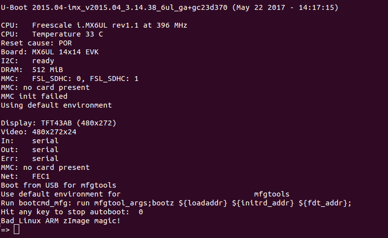

4.- Load U-boot
If an SREC file of U-boot is not present build it (meta-toolchain installed required) the SREC file contains all the information required by the probe to load it and makes this process easier.
To build the SREC simply type:
make <your board defconfig>mx6ul_14x14_evk_defconfig  (all supported boards are found under u-boot_dir/configs)
make
If you cannot build an SREC or do not want to, you can use the u-boot.imx (located under yocto_build_dir/tmp/deploy/images/<your board name>/) or u-boot.bin files but you will need to figure out the start address and load address for these files, this can be done by examining the IVT on u-boot.imx (here is a useful document explaining the structure of the IVT).
Let U-boot run and you should see its output on the console I will try to boot from several sources but it will fail and show you the prompt.

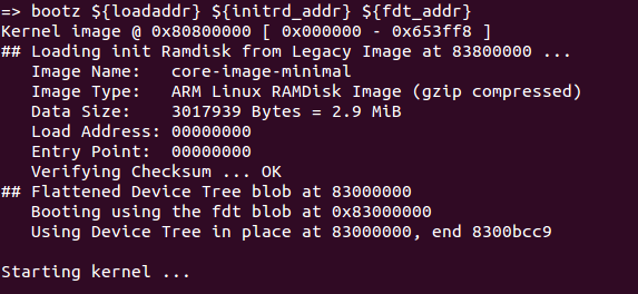

7.- Load zImage, DTB and RAMDisk
Now we know where to load our zImage, device tree blob and RAMDisk, on Lauterbach this can be achieved by running the following commands:
Stop the target and execute:
data.load.binary zImage.bin 0x80800000
data.load.binary Your_device.dtb 0x83000000
data.load.binary core-image-minimal-RAMDISK.rootfs.ext4.gz.u-boot 0x83800000
Let the device run again and deattach from the device in lauterbach this is achieved by:
go
SYStem.mode.NoDebug
start the boot process on u-boot as follows:
bootz ${loadaddr} ${initrd_addr} ${fdt_addr}
You should now see the Linux kernel boot process on your terminal:
After the kernel boots you should see its prompt on your terminal:
