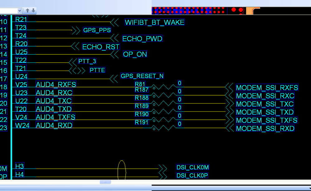

Dear *,
I have a schematic like this:
I know that the MODEM_SSI_TXD provide the data output to a DAC, now I would like capture this data.
Is right the configuration of AUD4_TXD to MODEM_SSI_TXD?
Or the right configuration is AUD4_RXD to MODEM_SSI_TXD?
Best Regards
Cristian

Hi Cristian
both options are possibel since AUDMUX can change TX and RX by bit
TXRXEN, 0 No switch (Transmit Pin = Transmit, Receive Pin = Receive)
1 Switch (Transmit Pin = Receive, Receive Pin = Transmit)
igor
