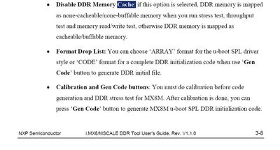

We have created a custom board with a imx8mm processor and a nanya NT6AN128T32AV memory chip of 4Gb.
We started by creating a memory file for the mscale_ddr_too v.3.20 and managed to get a configuration/calibration working, testing the memory is fine as long as we set the  "Disable DDR Memory Cache" option.
When we enable cache we get errors like:
t1: memcpy SSN armv8_x32 test
.Address of test1 failure: 0x000000005000A348
Data was: 0xF7FFFFFF00000200
But pattern was: 0xFFFFFFFF00000200
and
.Address of test1 failure: 0x0000000050039F18
Data was: 0xF7FFFFFF00000008
But pattern was: 0xFFFFFFFF00000008
Source is wrong, it is: 0xF7FFFFFF00000008
Address of source failure:0x0000000040039F18
Attached a log of ddr tool.
I do not understand what D-Cache has to do with layout of DDR memory.

igorpadykov
cache is explained in MSCALE_DDR_Tool_User_Guide from link
https://community.nxp.com/t5/i-MX-Processors-Knowledge-Base/i-MX-8M-Family-DDR-Tool-Release/ta-p/110...
One can try different drive strength and ODT settings (search them in RPA file) to see if some combinations allow you to pass
igor
