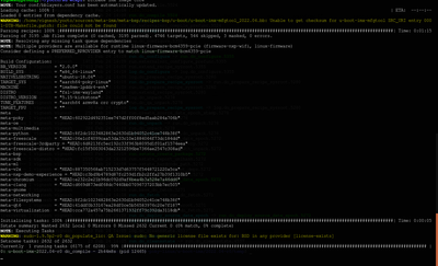

We were trying to build yocto build for imx8mm-lpddr4-evk.
$ DISTRO=fsl-imx-wayland MACHINE=imx8mm-lpddr4-evk source imx-setup-release.sh -b <build folder>
$ bitbake imx-image-core
This is fresh build, we didn't made any changes to it.
Currently 1 running tasks (6175 of 6208) 99% |###################################################################################################################### |
0: u-boot-imx-2022.04-r0 do_compile - 2h42m3s (pid 12465)
it was stuck like this.
Can you let us know any solution to this one?
