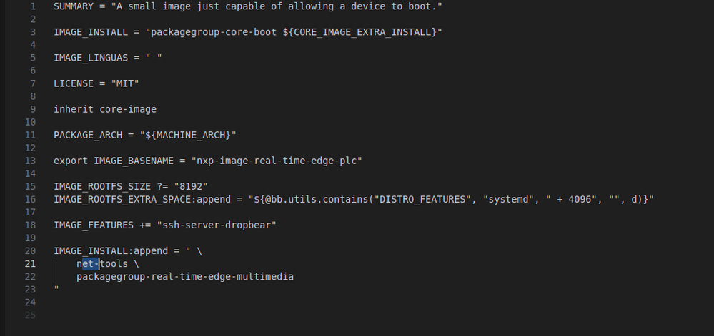

Please try to modify the recipe, using default configuration as reference. Add:
packagegroup-real-time-edge-multimedia \
meta-real-time-edge/recipes-nxp/images/nxp-image-real-time-edge.bb at master · nxp-real-time-edge-sw...
meta-real-time-edge/recipes-nxp/images/nxp-image-real-time-edge-plc.bb at master · nxp-real-time-edg...
Best regards.
1,035 Views
ZenJeams
I added packagegroup-real-time edge-multimedia to the configuration of nxp image-real-time edge-plc.bb as you suggested, but the problem is still the same.
1,016 Views
JorgeCas
Please try to use nxp-image-real-time-edge.bb and add:
net-tools \
Maybe there is a dependency in the packages.
Best regards.
