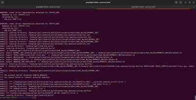

Hello!
I'm following this guide https://www.nxp.com/docs/en/user-guide/Android_Auto_User's_Guide.pdf but when I run this command:
./imx-make.sh -j4 2>&1 | tee build-log.txt
I receive this error:
Screenshot from 2025-06-02 16-47-55.pngScreenshot from 2025-06-02 16-47-55.png
In the guide there is no any information about this. Where I should set this CONFIG_MODULES flag?

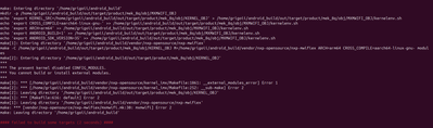

3. I run those 2 commands and nothing happened:
Screenshot from 2025-06-03 12-50-02.pngScreenshot from 2025-06-03 12-50-02.png
 after that I run:
and received the same error:
Screenshot from 2025-06-03 12-56-06.pngScreenshot from 2025-06-03 12-56-06.png

Grigoriy
Ok, thank you very much! Turned out I downloaded imx-android 15.0.0_1.2.0 instead of
imx-automotive-15.0.0_1.1.0.
