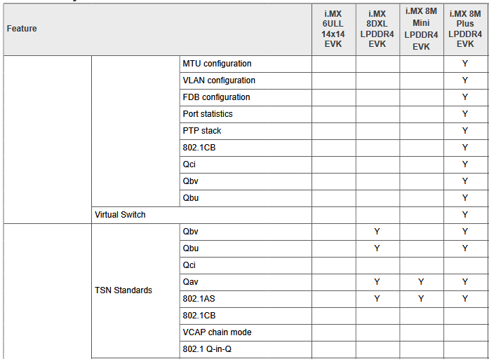

Dear NXP support,
the Linux source code of eQOS driver manages the supported PTP features here
    https://github.com/varigit/linux-imx/blob/lf-6.6.y_6.6.52-2.2.0_var01/drivers/net/ethernet/stmicro/s...
but we cannot find reference to L2 support.
Does the HW support L2 ?
If yes, is there any plan to add it ?

Thank you for your interest in NXP Semiconductor products,
What features of PTP L2 do you need? I would strongly recommend you to check NXP BSP, either Linux Factory or Real Time Edge.
i.MX 8M Plus EQOS IP includes L2 (filtering) support through MAC DA/SA and VLAN filtering, RTEdge supports:

Hi @JosephAtNXP,
as far as I can see from the kernel code, PTP L2 require dedicated support in the kernel driver
  • ptpv2-l2-event => HWTSTAMP_FILTER_PTP_V2_L2_EVENT
  • ptpv2-l2-sync => HWTSTAMP_FILTER_PTP_V2_L2_SYNC
  • ptpv2-l2-delay-req => HWTSTAMP_FILTER_PTP_V2_L2_DELAY_REQ
I'm not able to find any management for them in the eqos driver as provided in the offcial NXP BSPs.
Could you please confirm ?
