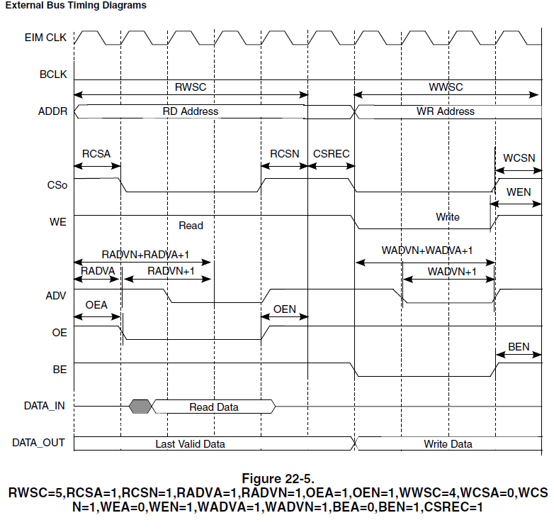

My configure set below,
YOCTO
kernel : 3.14.52
i.mx6dl sabresd
ununtu 14.04
EIM max frequency 133Mhz...
According to fig.22-5 , real data rate  is 133/6 Mhz for data transfer?  = 22Mhz?
How to think about EIM timing chart?
I will use multiplexed address/data mode - 16bit. Can i use more fast clock than 22Mhz?

Most effective approach is using burst mode, where data can be accessed every
burst clock. In such way maximum frequency of 133 MHz may be achieved with EIM
during bust.
