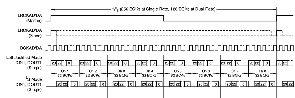

I have a question about i.MX6DQ ESAI.
I understand SSI network mode cannot add padding data in i.mx6 SSI in TDM mode .
Then, how about ESAI network mode?
ESAI network mode cannot add padding data as the following image also?

Hi Satoshi
ESAI is able to add padding data, as shown in above diagrams.
In ESAI network mode it can output/receive 32 bits per slot, set by
SLOT LENGTH=32, described in Table 25-6. ESAI Transmit Slot
Table 25-9. ESAI Receive Slot i.MX6DQ Reference Manual
http://cache.freescale.com/files/32bit/doc/ref_manual/IMX6DQRM.pdf
