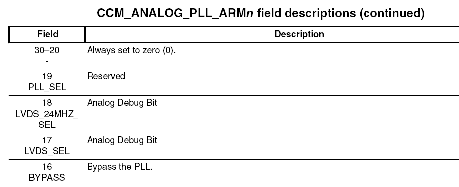

Dear community.
Our customer has question below.
Please tell me the function explanation and default set value of register of CCM described in IMX6DQRM.
CCM_ANALOG_PLL_ARMn
bit17LVDS_SEL
bit18LVDS_24MHZ_SEL
bit19PLL_SEL
CCM_ANALOG_PLL_SYSn
bit18PFD_OFFSET_EN
CCM_ANALOG_PLL_AUDIOn
bit18PFD_OFFSET_EN
CCM_ANALOG_PLL_VIDEOn
bit18PFD_OFFSET_EN
CCM_ANALOG_PLL_ENETn
bit18PFD_OFFSET_EN
bit19ENABLE_125M
bit20ENABLE_100M

Hello Takashi Takahashi,
I received confirmation that in general these are debug or reserved bits that do not need to be programmed by the customer.
CCM_ANALOG_PLL_ARMn
bit17LVDS_SEL
bit18LVDS_24MHZ_SEL
bit19PLL_SEL
In this case the default value is the one shown on the Reference Manual.
CCM_ANALOG_PLL_SYSn
bit18PFD_OFFSET_EN
 As for PDF_OFFSET_EN, this is a test bit. PDF stands for Phase Frequency Detector, not Phase Fractional Divider. The purpose of it is to reduce PLL charge pump nonlinearity. It should not be programed and it will be updated on future releases as reserved.
bit19ENABLE_125M
bit20ENABLE_100M
The ENABLE_100M and ENABLE_125M bits in CCM_ANALOG_PLL_ENET enable the output of 100MHz clock and 125MHz clock from the ENET PLL, respectively. 100M clock is used for SATA and the 125M clock is used for PCIe.
