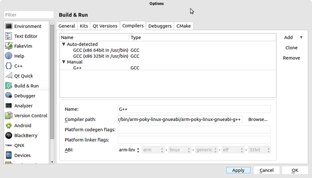

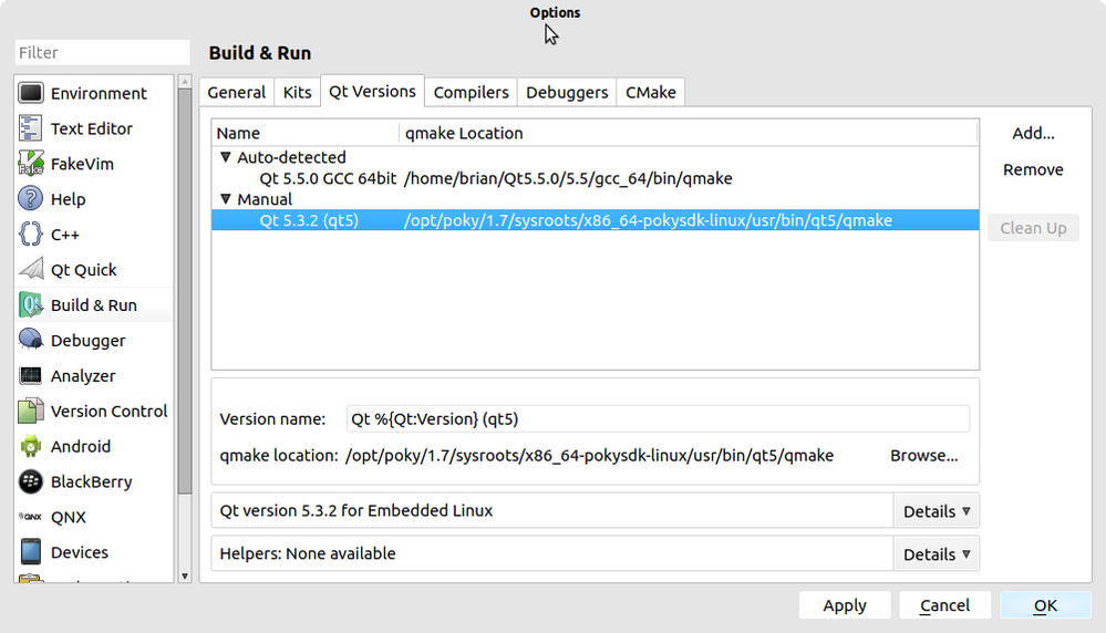

In QtCreator I set
Compiler as
             /opt/poky/1.7/sysroots/x86_64-pokysdk-linux/usr/bin/arm-poky-linux-gnueabi/arm-poky-linux-gnueabi-g++
Qt version as
                 /opt/poky/1.7/sysroots/x86_64-pokysdk-linux/usr/bin/qt5/qmake

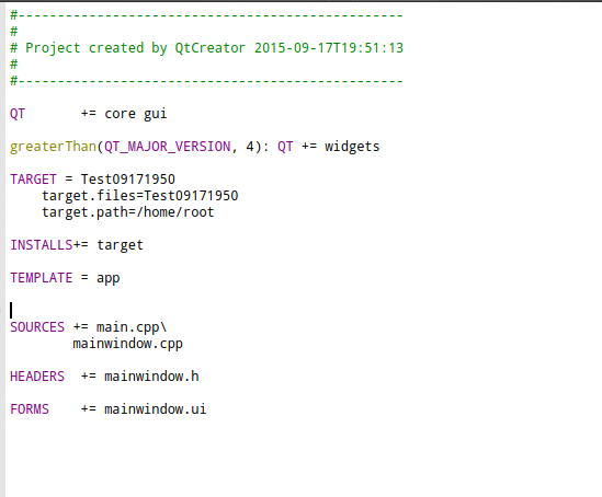

and then I build a new project and add some to the .pro file

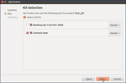

LuisCasado

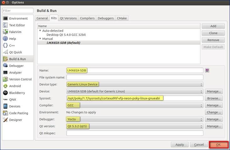

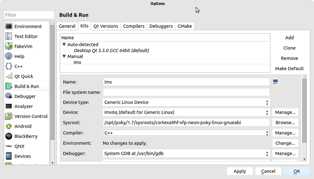

I configure the KIT :
And I select the KIT when I create the project:
The other configuration I have is the same as you.
Luis

LuisCasado
Luis

brianhuang
Hi Luis Casado
Thanks for your help.
I follow your setting. The build is OK.

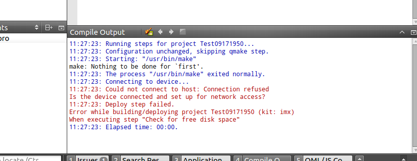

But I got another error ,when I use "Run" or "Deploy All" .

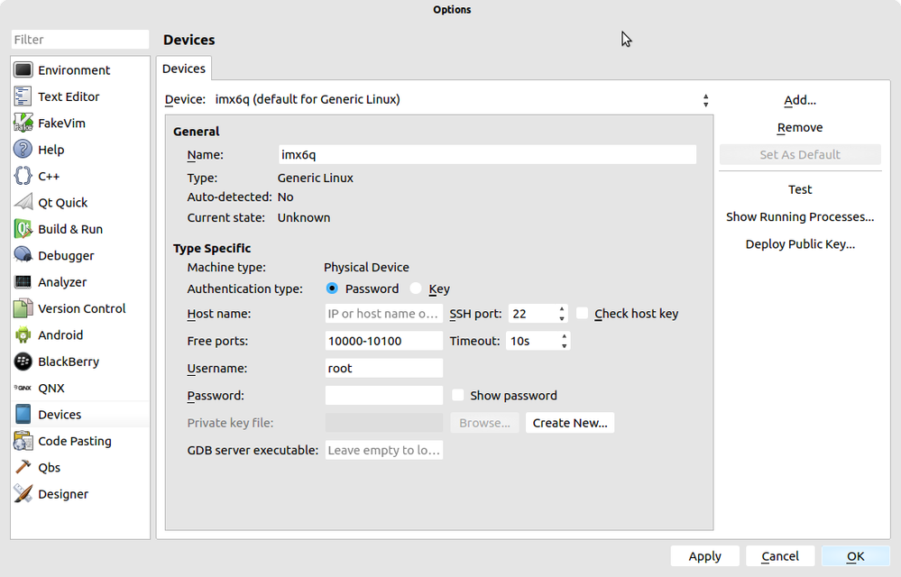

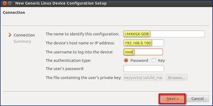

My Device setting as
My question is
Could I deploy an qt output file on my PC and copy this file to SD  and excute like as "./qtoutputfile " on my i.MX6Q-sabresd board?

isaac_ng
It seems using openssh instead of dropbear could get it to work.
Test on L3.14.28_1.0.0-GA release and this is my local.conf:
MACHINE ??= 'imx6qsabresd'
DISTRO ?= 'poky'
PACKAGE_CLASSES ?= "package_rpm"
EXTRA_IMAGE_FEATURES = "debug-tweaks ssh-server-openssh tools-debug eclipse-debug"

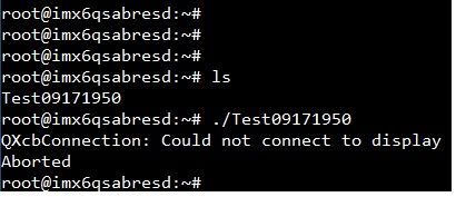

brianhuang
Hi All,
Thanks for your explanation. I understand the meaning of this setting.
I don't use network. Because My mockup doesn't have network.

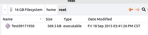

I try the below steps ,but fail.
1.After I built my project, I got  this file "Test09171950"
2.I copy this file "Test09171950" to the root file system in my SD Card
3.I excute this qtapplication by command line. but I got error.
How can I fix this problem?
Thank you.
5,421 Views
LuisCasado
Try :
$export DISPLAY=:0
Luis
5,421 Views
brianhuang
Hi Luis Casado,
Thanks for your help.It's OK.
Is the setting  "$export DISPLAY=:0 " necessary for Qt application?
5,421 Views
LuisCasado
No for QT, but for X11 backend.
The DISPLAY variable is not used by X itself.  It tells X11 applications which screen they should run on. The reason this variable is needed is because you can have multiple X servers running locally, or you may wish to use a remote display. So if the DISPLAY variable is not set, your X11 apps have no idea where you want them to run.
Luis

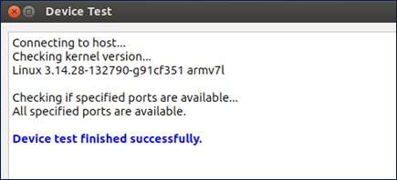

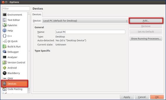

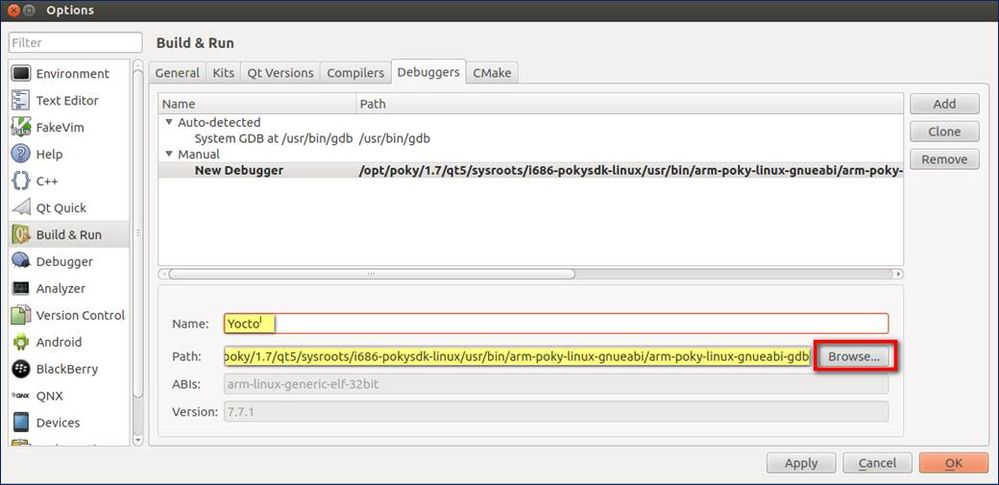

I have this configuration on the QT creator for debugger and device:
In my conf/local.conf
I have:
EXTRA_IMAGE_FEATURES = "debug-tweaks tools-debug eclipse-debug ssh-server-openssh"
CORE_IMAGE_EXTRA_INSTALL += "openssh-sftp openssh-sftp-server"
And also don't forget add to your *.pro file
target.path = /home/root
INSTALLS += target
