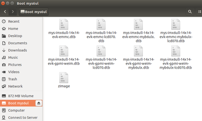

I built fsl-image-qt5 and load it on SD card. But the board doesn't proceed initialization after "Normal boot" line and doesn't start autoboot countdown. What's the issue?
Log:
U-Boot 2016.03-mys-6ulx+ga175019 (Dec 02 2021 - 00:45:10 -0800)
CPU: Freescale i.MX6ULL rev1.1 528 MHz (running at 396 MHz)
CPU: Industrial temperature grade (-40C to 115C) at 33C
Reset cause: POR
Board: MYS-MX6ULL 14x14
I2C: ready
DRAM: 256 MiB
force_idle_bus: sda=1 scl=0 sda.gp=0x1d scl.gp=0x1c
NAND: 256 MiB
MMC: FSL_SDHC: 0
Display: TFT43AB (480x272)
Video: 480x272x24
In: serial
Out: serial
Err: serial
Net: FEC0
Normal Boot
Here's boot partition contents:
ラベル(3)
2,315件の閲覧回数
totalit
I solved this. The thing is, bootcmd variable in Uboot was not set. I did setenv bootcmd "fatload mmc 0 $loadaddr boot.scr; source $loadaddr"  to place my script at the beginning of boot, so now it works.

igorpadykov
may be recommended to run ddr test
https://community.nxp.com/t5/i-MX-Processors-Knowledge-Base/i-MX-6-7-DDR-Stress-Test-Tool/ta-p/11082...
then update image with new ddr calibration coefficients as described in sect.3.2.1 Changing the DCD table for i.MX DDR initialization   i.MX Porting Guide​
igor
2,326件の閲覧回数
totalit
I run DDR test, wrote new coefficients to u-boot, but it caused no result, I still get "Normal boot".
