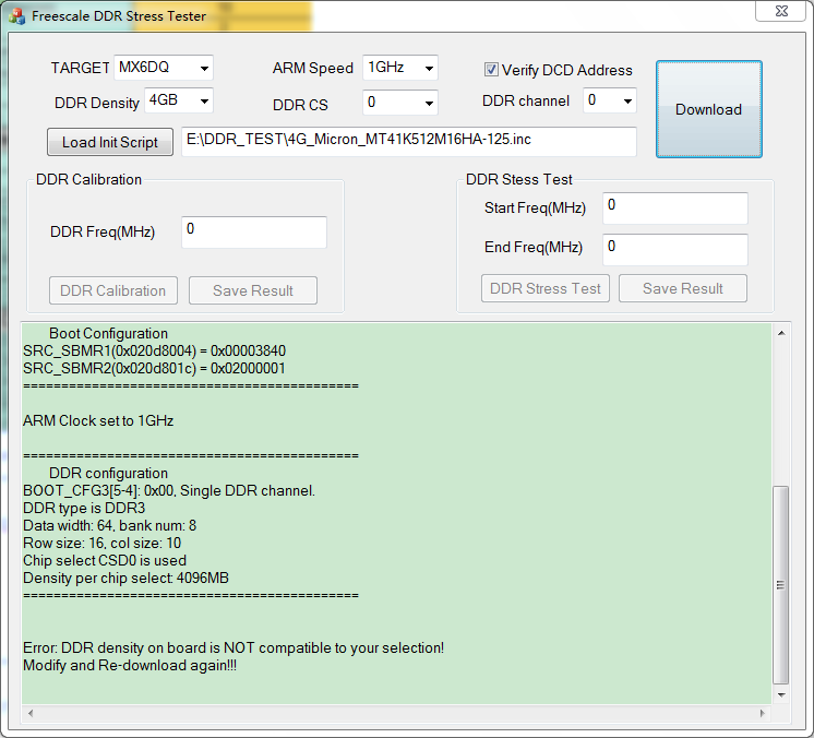

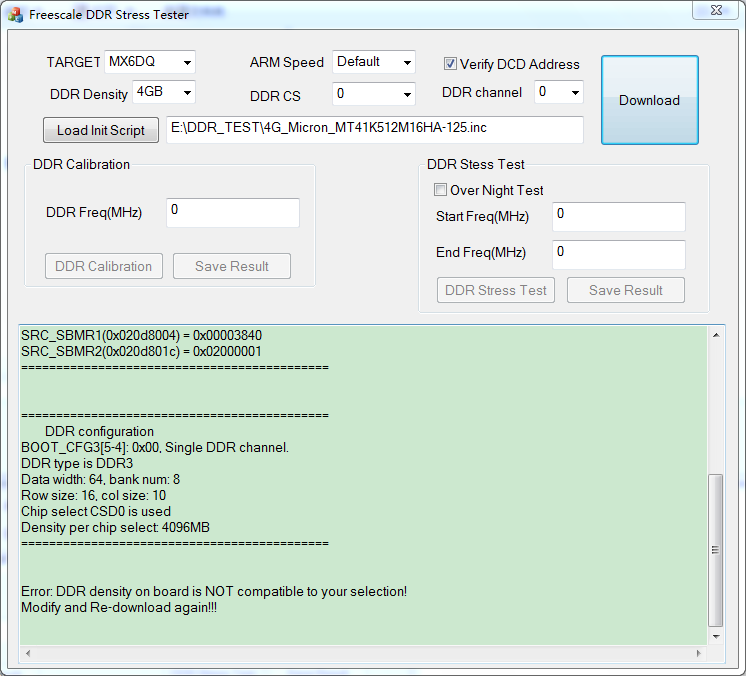

Hi, Sir
I just use this tester and it report below error on my board.
DDR configuration
DDR type is LPDDR2 in 1-channel mode.
Data width: 32, bank num: 8
Row size: 14, col size: 10
Both chip select CSD0 and CSD1 are used
Density per chip select: 512MB
Error: DDR density on board is NOT compatible to your selection!
Modify and Re-download again!!!

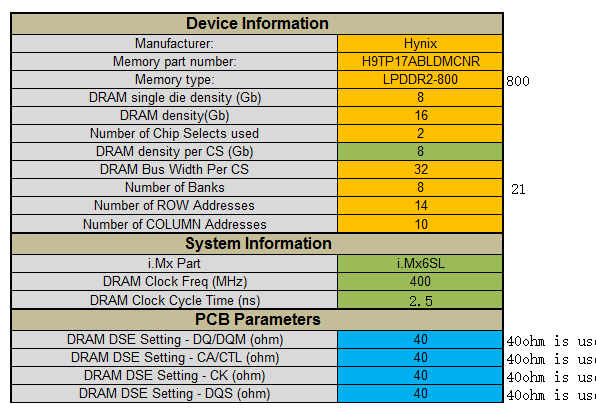

But I've use the Mx6SL LPDDR2 Script Aid V0.04 tool to generate the inc file with below config
Would you please give a guidence what's wrong with this?
well, according to your spread sheet entry you use two chip select with 1GByte each. The stress test however
calculated that you use only 512MBytes per chip select ...
if you use 8 banks / 14 row addresses and 10 column addresses you have a density of: 8 * 2^10 * 2^14 = 8 * 1024 * 16384 = 128MWords.
With 32Bit wide memories this results in 512MBytes per device or 1GBytes in total.
So I would say the stress tester is wrong and your entries are correct.

We are still having errors with 4GB selected with V2.2 for i.mx6Q.
Used the programming aid to generate .inc file.
This .inc file works with 1.0.2.
The settings in the .inc work with uboot/Linux
So, we believe the settings are valid, but V2.2 is still giving an error.
DDR Stress Test (2.2.0)
Build: Sep 21 2015, 23:32:59
Freescale Semiconductor, Inc.
Chip ID
DIGPROG(0x020c8260) = 0x00630002
CHIP ID = i.MX6 Dual/Quad (0x63)
Internal Revision = TO1.2
Boot Configuration
SRC_SBMR1(0x020d8004) = 0x04003040
SRC_SBMR2(0x020d801c) = 0x3a000001
DDR configuration
BOOT_CFG3[5-4]: 0x00, Single DDR channel.
DDR type is DDR3
Data width: 64, bank num: 8
Row size: 16, col size: 10
Chip select CSD0 is used
Density per chip select: 4096MB
Error: DDR CS on board is NOT compatible to your selection!
*****************************U_BOOT_JTAG_VERSION*************************************************
