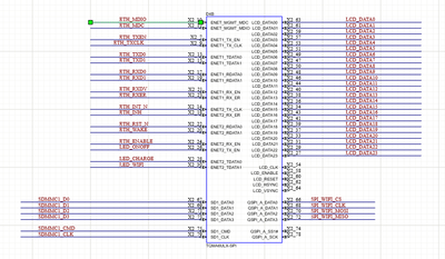

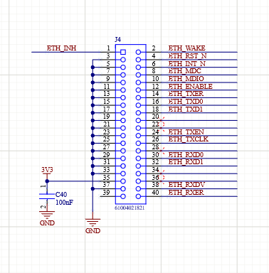

We made a design using an imx6ul SOM and a TJA1101 evaluation kit (TJA1101AHN).
When linux starts (built with yocto), the phy is detected but when we try to send some data via ethernet. there is none transmitted. We have two identical boards linked.
Could you please check our dts file ?
We are able to give the eth0 interface an ip through ifconfig command.
I attached thereby the dts file and the schematics as well as the dmesg content.

The reset signal is kind of weird, it moves from 3,4V to 2,8V but never goes down to zero. We modified our dts to remove internal pull-ups given that there are already external ones on the tja1101 devkit. Another weird signal is the MDIO line which doesn't move except when restarting board (we tried ifconfig eth0 up/down and ip commands) : it stays at 3,3V.

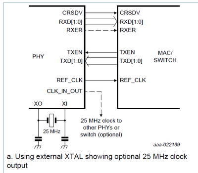

We modified the value in iomux.h from IOMUX_GPR1_FEC1_CLOCK_MUX1_SEL_MASK (0x1 << 17) to IOMUX_GPR1_FEC1_CLOCK_MUX1_SEL_MASK (0x0 << 17) so it is used by setup_fec(). This modified our REF CLK frequency but it doesn't match our expectations. On the devkit, using jumpers, we asked for 25MHz and we have 50MHz. When we do the contrary (we put jumpers to have 50MHz), we observe a 25MHz clock frequency. In our device tree, we removed the tja11xx,refclk_in line. From the driver and phy point of view, the REF CLK should be out right ? Because there is an oscillator on the board and we follow the model from tja1101ahn figure 4.a.
