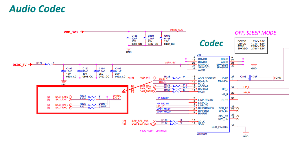

I am redesigning custom circuit board using I.MX8 mini.
in the schematic of the IMX8mini EVK board using Audio IC WM8524 (Line out levels only for audio). but now I want to use MIC input and Headphone out, so which IC audio codecs can I use?
Can you suggest me?

I'm trying to use WM8960, but which DACLRC / BCLK sync signal can be connected to? SAI_TXFS / SAI_TXC or SAI_RXFS / SAI_RXC.
Sorry to bother, but please help
Many thanks
9,516 Views
Rita_Wang
Many IC you can use, such as WM8960, WM8962, SGTL5000.

haryanl
thank you so much
