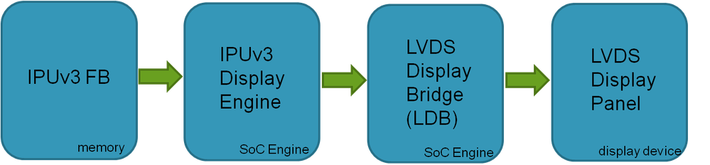

LVDS display panel driving data flow:
Display quality:
To get the best display quality for 24bit LVDS display panel in Android, we should use 32bit framebuffer, make IPUv3 display Engine and LDB output 24bit pixels, since RGB component information is aligned from source to destination.
