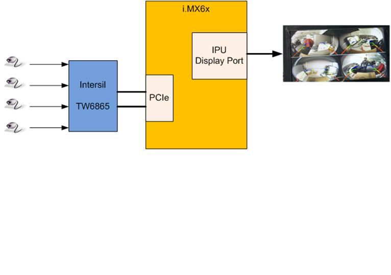

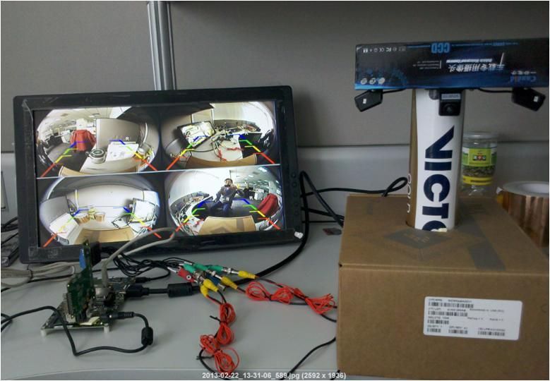

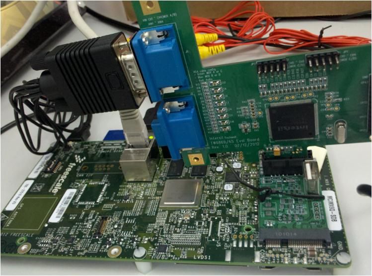

We use PCIe to connect Intersil TW6865 chip for the surround view solution.
This is the block diagram of the connection:
This is the 4 camera surround view:5173_5173.JPG4.JPG

What's the CPU occupancy when run the application? Thanks.
Tested on my local side:
Test with Top  command:
Mem: 109772K used, 787076K free, 0K shrd, 3520K buff, 24616K cached
CPU: 12.2% usr 15.3% sys  0.0% nic 63.7% idle  0.0% io  0.0% irq  8.6% sirq
Load average: 7.02 5.16 2.56 4/94 3535
Test with MMDC tool:
root@freescale ~$ ./mmdc_prof
MMDC new Profiling results:
Total cycles count: 528091007
Busy cycles count: 385370313
Read accesses count: 9834967
Write accesses count: 10137409
Read bytes count: 466175272
Write bytes count: 379222896
  1. Read burst size: 47
  2. Write burst size: 37
Read: 444.58 MB/s /  Write: 361.66 MB/s  Total: 806.23 MB/s
Utilization: 13%
Bus Load: 72%
Bytes Access: 42
Hi JiangJustin
I am doing the same thing as you did above.
But my tw6865 card can't be identified. Bellow is what i have done.
1 .  I add the patch file to the kernel, version is L3.0.35_4.1.0_130816
2.   Change the kernel configure within make menuconfig to enable tw6865.
3.   Build the kernel and write it to my SD card. I am using i.mx6q sabreSDB board.
4.   Attach the mini-pcie=>PCIe adaptor and attch TW6865 card to adaptor's pcie slot.
5.   Boot the board, when system is up. use "lspci" to display the device. But there is nothing.
6.   Check the kernel boot message with "dmesg", there are errors as bellow:
iMX6 PCIe PCIe RC mode imx_pcie_pltfm_probe entering.
PCIE: imx_pcie_pltfm_probe start link up.
link up failed, DB_R0:0x004abc43, DB_R1:0x08000000!
IMX PCIe port: link down!
It seems like that link up was failed.
could you give me some advices to slove this?
Thank you very much.

Please make sure you config file about pcie aligned to the following:
# MX6 Options:
CONFIG_IMX_PCIE=y
# CONFIG_IMX_PCIE_EP_MODE_IN_EP_RC_SYS is not set
# CONFIG_IMX_PCIE_RC_MODE_IN_EP_RC_SYS is not set
My configuration is same with yours.
Where you get the pcie switch to connect tw6865. It seems that not all of pcie switch can work  friendly. You can try some other pcie device to test. Actually, now we have mini-pcie interface daughter card for tw6865.
I buied the mini-pcie->pciex1 switch card from www.taobao.com.
and confirm it works with an intel gigabit ethernet card .
ethernet card can be recongnized by the board.
By the way,where can i buy the tw6865 daughter board you said?
Thank you

Thank you, could you confirm the pcie clock's enable mentioned at bellow message in another discussion.
>Hongxing, thank you for your response.
>I use L3.0.35_4.1.0_130816_source.tar.gz downloaded from freescale's IMX6QSD platform resource website.
>Now, the problem has been solved. The PCIe clock output was not enabled in the code when IMX6 worked as RC.
PCIE link up failed when booting the kernel on IMX6QSD board
And when you did this things at begin, before use the daughter card,
which switch card you used? Can you give me an url of it where i can buy it from.
Thank you.
Or can i borrow the daughter card,
or borrow(buy) your old environment (mini-pcie2pcie switch card & tw6865 pcie card)
If we enable CONFIG_IMX_PCIE_EP_MODE_IN_EP_RC_SYS item, the pice reference clock will not output by default , and it will work in separate clock mode. So we checked the .config file firstly.
If you can recognize other pcie device,  I think your issue  is not same with this.

I tried another case.
I put the tw6865 card and the minipcie2pcie switch to the notepc's mini-pcie slot,
And it can be linked up.
If there is no other way, i plan to create the daughter board use your board data.
but it will take a long time.
If that is ok, may i borrow your daughter board? or i wish to buy one.

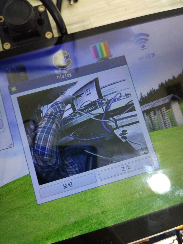

I am doing the same thing! I use the tw6865 and  I can read the picture from the cameras.what confuse me is that I can not change the resolution of the caption.
I use V4L2 lib to config the camera,when it is configed with 720*576, i will get a full picture,just like this:
when it is configed with other resolution,such as 360*288,640*480 and 320*240, i will get a Incomplete picture ,just like this:
I use a definition to define the resolution:
#define  IMAGEWIDTH    720
#define  IMAGEHEIGHT   576

Hi~Dear
     Now I encounted some problems when i use the patch in IMX6 Community.
     My Applitcatin is mxc_v4l2_tvin.out. But It can't use V4L2_MEMORY_USERPTR mode to capture video stream,and it often displayed that "USERPTR is currently not supported ,buffer_prepare  OOPS".And it burn down.But when i use V4L2_MEMORY_MMAPED,it can normally capture video stream.
The command is :
hdmi
./mxc_v4l2_tvin.out -x 0 -ot 0 -ol 0 -ow 960 -oh 540 -m 2 &
./mxc_v4l2_tvin.out -x 1 -ot 0 -ol 960 -ow 960 -oh 540 -m 2 &
./mxc_v4l2_tvin.out -x 2 -ot 540 -ol 0 -ow 960 -oh 540 -m 2 &
./mxc_v4l2_tvin.out -x 3 -ot 540 -ol 960 -ow 960 -oh 540 -m 2 &
hardware platform: IMX6Q-SABRESED + PCIE + TW6865
LTIB: L3.0.35_4.1.0_130816_source.tar.gz
Could you teach me that how to save the data captured by the lens?
Have a good day!
Hi hu bing,
    What about your problem of capture ?
     It is kind that help me a demo about V4L2 code.There is my email 1058477863@qq.com.
     Thanks!

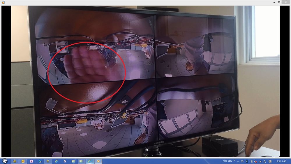

Hi, Qingrong Jiang!
I'm a FAE from STC, one of the NXP distributors in Korea.
We made TW6865 test board, and we can see 4ch image on HDMI with MX6Q-SABRESDP.
But we can see afterimage when I move my hand fast in front of Camera. (Please see attached video clip.)
(BSP version : L3.0.35_4.1.0)
I met intersil FAE, and he said it is the problem of deinterlacing.
Do you have any guide or solution to solve this issue?
Dear Qingrong Jiang​:
When I use this methord to get the data of images by the v4l2 capture.c,
I meet like this:
i.MX6Q +PCIE+TW68 驱动显示等问题-恩智浦MCU论坛论坛 - 21ic电子技术论坛
can you check with our Korea FAE. They should have some patches for it.
But we can see raster images when I move my hand fast in front of Camera.

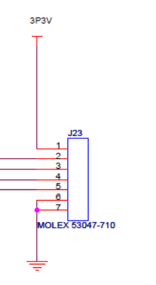

Dear JiangJustin ,
We have developed a camera board using Intersil TW6865 chip (As same as Freescale TW6865 miniPCIe Daughter Board) which can input two analog cameras to iMAX6Q Sabre Lite Development board using PCIe interface.
I need to clarify following >>
In iMAX6Q Sabre Lite for PCIe port there are 7 pin connections as follows. +3.3V, PCIE_RXM, PCIE_RXP, PCIE_TXM, PCIE_TXP, GND, GND.
Intersil TW6865 chip has REFCLK-, REFCLK+ pin connections for differential reference clock inputs.
Don't we need to connect this pins with iMAX6Q board if we want to interface with PCIe interface ?
Thank You,

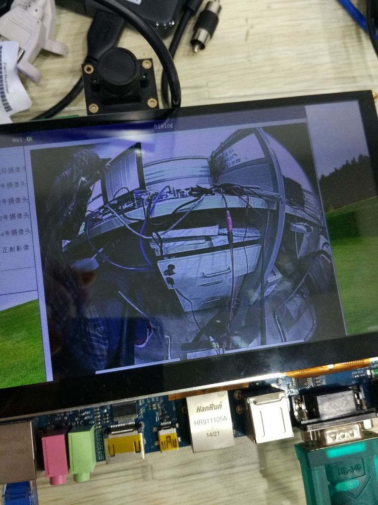

Hi, Justin Jiang .
My board has a lvds lcd, now it is able to display the qt demo, I have also attached the tw68 to the board. The "lspci" command output is below:
00:00.0 PCI bridge: Synopsys, Inc. Device abcd (rev 01)
01:00.0 Non-VGA unclassified device: Intersil Techwell Device 6869 (rev 01)
So, is the command below able to display the video on the lvds lcd? If not, how to change it.
gst-launch v4l2src device=/dev/video0  ! 'video/x-raw-yuv, format=(fourcc)UYVY' ! mfw_isink disp-width=960 disp-height=540 &
gst-launch v4l2src device=/dev/video1  ! 'video/x-raw-yuv, format=(fourcc)UYVY' ! mfw_isink disp-width=960 disp-height=540 axis-left=960 &
gst-launch v4l2src device=/dev/video2  ! 'video/x-raw-yuv, format=(fourcc)UYVY' ! mfw_isink disp-width=960 disp-height=540 axis-top=540  &
gst-launch v4l2src device=/dev/video3  ! 'video/x-raw-yuv, format=(fourcc)UYVY' ! mfw_isink disp-width=960 disp-height=540 axis-top=540 axis-left=960 &
BTW, my kernel version is 4.1.15.
Thanks!
