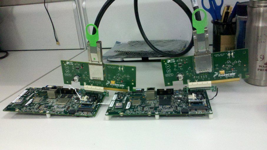

* Two i.MX6Q SD boards, one is used as PCIe RC; the other one is used as PCIe EP. Connected by 2*mini_PCIe to standard_PCIe adaptors, 2*PEX cable adaptors, and one PCIe cable.
* When building RC image, make sure that
CONFIG_IMX_PCIE=y
# CONFIG_IMX_PCIE_EP_MODE_IN_EP_RC_SYS is not set
CONFIG_IMX_PCIE_RC_MODE_IN_EP_RC_SYS=y
* When build EP image, make sure that
CONFIG_IMX_PCIE=y
CONFIG_IMX_PCIE_EP_MODE_IN_EP_RC_SYS=y
# CONFIG_IMX_PCIE_RC_MODE_IN_EP_RC_SYS is not set
* Set-up link between RC and EP by their stand-alone 125MHz running internally.
* In EP's system, EP can access the reserved ddr memory (default address:0x40000000) of PCIe RC's system, by the interconnection between PCIe EP and PCIe RC.
NOTE: The layout of the 1G DDR memory on SD boards is 0x1000_0000 ~ 0x4FFF_FFFF)
Use mem=768M in the kernel command line to reserve the 0x4000_0000 ~ 0x4FFF_FFFF DDR memory space used to do the EP access tests.
(The example of the RC’s cmd-line: Kernel command line: noinitrd console=ttymxc0,115200 mem=768M root=/dev/nfs nfsroot=10.192.225.216:/home/r65037/nfs/rootfs_mx5x_10.11,v3,tcp ip=dhcp rw)

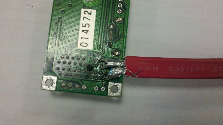

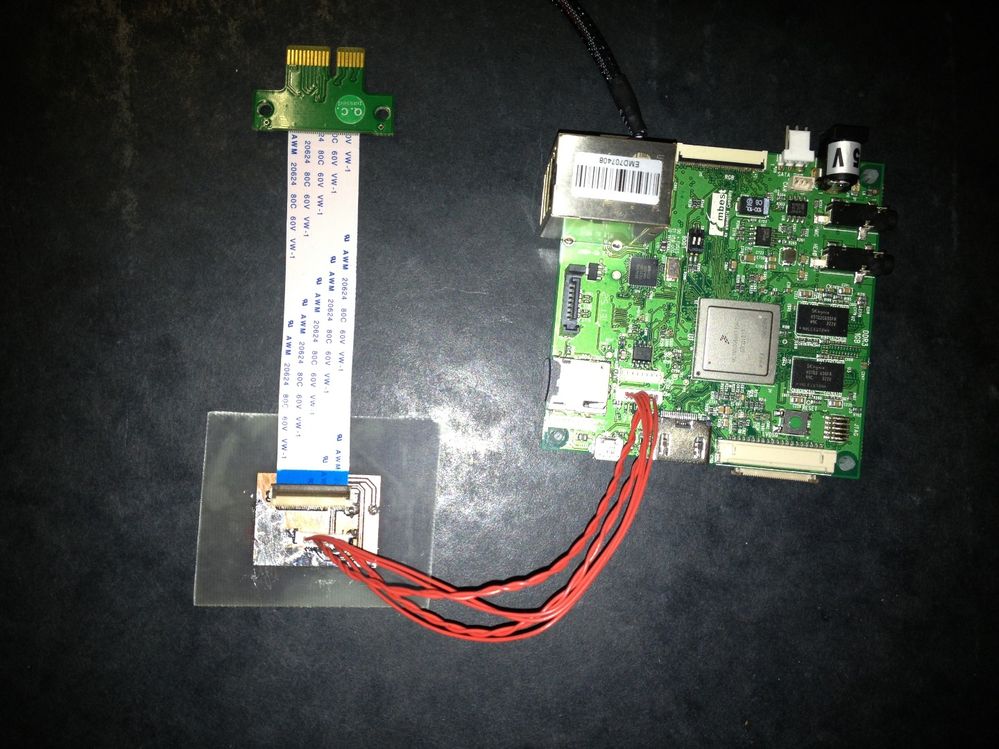

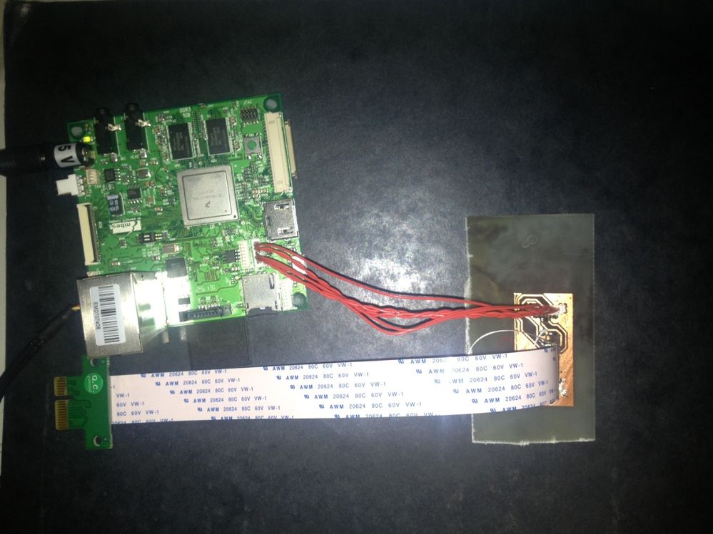

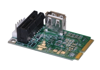

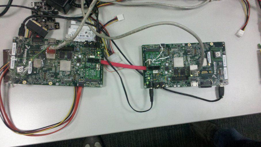

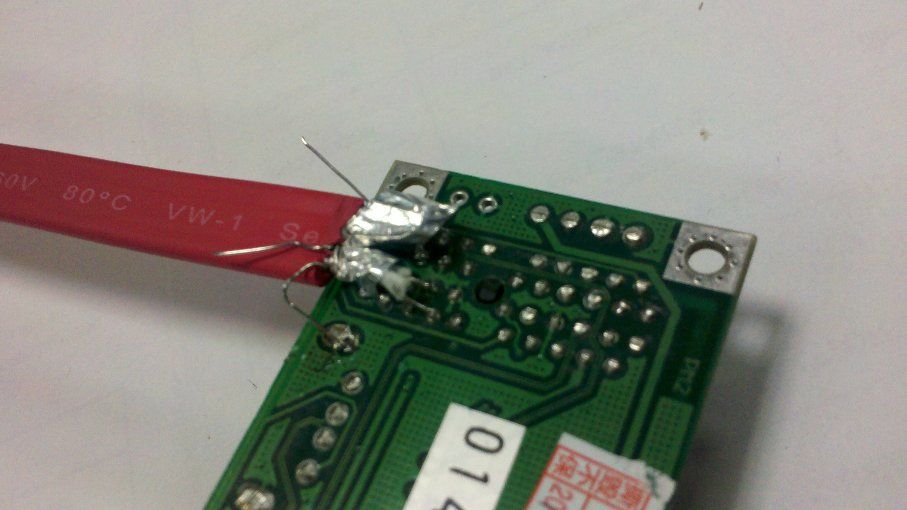

2* iMX6Q SD boards, 2* Mini PCIe to STD PCIe adaptors, one SATA2 data cable.
the mini-pcie to standard pcie exchange adaptor.
Here is the URL:
http://www.bplus.com.tw/Adapter/PM2C.html
Two adaptors, one is named as A, the other one is named as B.
A B
TXM <----> RXM
TXN <----> RXN
RXM <----> TXM
RXN <----> TXN
A1 connected to B3
A2 connected to B4
A3 connected to B1
A4 connected to B2
Connect the SATA2 data cable to Mini PCIe to STD PCIe adaptor (A)
Connect the SATA2 data cable to Mini PCIe to STD PCIe adaptor (B)
NOTE:
* Please keep length of Cable as short as possible. Our cable is about 12cm.
* Please connect shield wire in SATA2 Cable to GND at both board.
* Please boot up PCIe EP system before booting PCIe RC system.

This is a new uImage.It does not make any patch.And just followed the following configuration
CONFIG_IMX_PCIE=y
# CONFIG_IMX_PCIE_RC_MODE_IN_EP_RC_SYS=y
but pcie does not work.
there is nothing output followed the commend lspci.
Regarding to the your logs:
PM driver module loaded
link up failed, DB_R0:0x00b4f900, DB_R1:0x08200000!
IMX PCIe port: link down!
The PCIe link is still failed to be setup properly.
Do you provide the mandatory requirements required by your PCIe EP device, such as external power supply and so on ?
Or, can you ship one PCIe EP used by you to me?
Then I can try to re-produce this problem at my side.
Best Regards
Richard Zhu.

Do you use the standard PCIe EP device?
The mini-PCIe to STD-PCIe convertor is required if the STD-PCIe EP is used by you, right?
The convertor would impact the quality of the PCIe deeply, please pay attention to it.
Here is one recommended convertor.
Best Regards
Richard Zhu

I'm trying to use a Sabrelite board with IMX6Q as a PCIe EP.
I Created a PCIe Cable that goes from the PCIe Port (j23) to a little board where I have a molex connector, and that gets rooted to a FPC Flex connector all the way to the PCIe Goldfinger using one of those Raiser: http://www.bplustech.com/KZ/KZ-B21.html The schematic of this raiser can be found here: http://www.bplus.com.tw/PDF/KZ-B21_VER1_0_20130118A.pdf
Basically I Connect on the PCIe Goldfinger part the PRSNT1# -- PRSNT2# to tell the HOST PC that it's a x1 pcie:
then my setup could be resumed as:
GND -- GND
TXP -- RXP
TXM -- RXM
RXP -- TXP
RXM -- TXM
(http://whatsphere.com/pcie.jpeg)

So the behaviour is that the board boots, and blocks at: "PCIe EP: waiting for link up..." and as soon as I switch on the PC, it goes on all the way to the login prompt.
At that stage, knowing that by default the IMX6q is at 125Mhz and that the CLK signal are not connected on the PCIe connector of the board, so it uses internal PLL, and that the standard for PCIe is 100Mhz. Is it sure that the link isr really UP ?
Obviously on the PC side, if I issue a "lspci" I don't see anything. :smileysad:
The thing is that according to the patch, it's supposed to set the VID/PID to "DEADBEAF" but when I look at the memory, I see the default VID/PID:
$ ./memtool -32 01FFC000 20
Reading 0x20 count starting at address 0x01FFC000
0x01FFC000: ABCD16C3 00100000 00000001 00000000
0x01FFC010: 0000000C 00000000 00000008 00000001
0x01FFC020: 00000000 00000000 00000000 00000000
0x01FFC030: 00000000 00000040 00000000 000001FF
0x01FFC040: DBC35001 00000000 00000000 00000000
0x01FFC050: 01807005 00000000 00000000 00000000
0x01FFC060: 00000000 00000000 00000000 00000000
0x01FFC070: 00020010 00008700 00102010 0001CC12
So I must be doing something wrong. any help would be welcome.

Hi:
Wow, It's amazing, pcie link is still up, cable of the connector is a little long of your HW.
About link is up or not, you can make a double check on the bit4 of Debug Register 1(0x01ff_c72c), link is up if this bit is set.
Best Regards
Richard.
Hi, thx for your answer. My question was more: If it says link is UP, is it really UP ? or is it just because there is some electrical activity on the RX path ?
Right now, I believe the board is at 125Mhz and not 100Mhz (how can I check that?) and since it's inserted inside a PC, the freq of the bus in a PC should be 100Mhz, no ? in this case how would the link be up ?
Also, on the PC side, I don't see any PCI interface corresponding to the board as a memory device when I issue a "lspci". So does your patch for EP and "emulating a memory device" work for beeing seen as a memory device on the other side ?
regards
Hello.
I have same issue as "keytwo.
Short cable help me avoid the problem when kernel hang up after message "PCIE: Waiting for link up..." (or something like this).
Now kernel booting right, but i have no "dead_beaf" device on root complex.
I use PC on root complex side. My question is "Is it possible to make the board working as EP with usual PC with usual linux 3.11?" I have no more freescale boards.
Regards.
I just checked my register with memtool. "while(true) ; do sleep 1 ; ./memtool -32 01ffc72c 1 | grep -v add | grep 0x; done"
in fact the 4th bit switches from 1 to 0 then 1 again.. randomly.
so maybe something is wrong with my cable. or, it's the fact that my device might be sync at 125Mhz while the normal PCI bus is sync at 100Mhz therefor it desync and link goes down.
richard.zhu How do I know if I'm in 125Mhz or 100Mhz ?
Too bad there is no demonstration of how to turn the device into EP with a normal PC instead of 2 Sabre boards.
aleksandrmuraviov Could you post a pic of your setup ?
On the board i'm using, the TX+/TX- signals get separated for a couple of centimeters because i was doing single face PCB, so that might be the reason it doesnt work.
keytwothat is - https://community.freescale.com/docs/DOC-98614

After checking the uplink register on a while loop, i realized that my device was in fact loosing the link up.
So i decided to make a new cable, where I respect the proximity of the TX/RX lines by putting the track right next to eachother, with a new type of connector
so on one side I come from the SABRE Lite J23 connector, to my little adapter, and that goes to a KZ-B21 ( http://www.bplus.com.tw/ExtenderBoard/KZ-B21.html )
I tested this one on several PC, and on one of them (just one) when I do a "lspci" i see my dead:beaf device as a RAM pcie card.
On the Sabrelite, the link stays UP (0x00000310) It looks like the cable was really an issue here.
I still can not read the PC's memmory.
I still don't know if the device is working on 100Mhz or 125Mhz and if I don't have a clock problem. What I know for sure is that on another PC, the link gets UP and Down non stop. So I still wonder if I don't have a clock issue.
