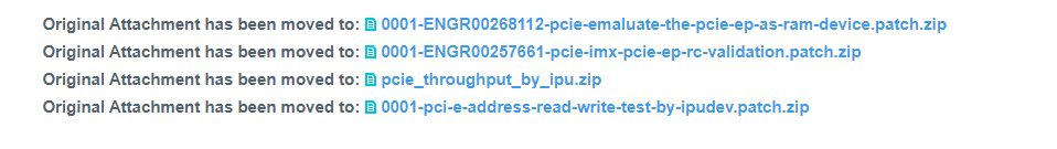

Base one imx_3.0.35 mainline, the patch, and the IPU test tools had been attached.
NOTE:
* IPU tests usage howto.
Unzip the xxx.zip, and run xxx_r.sh to do read tests, run xxx_w.sh to do the write tests.
