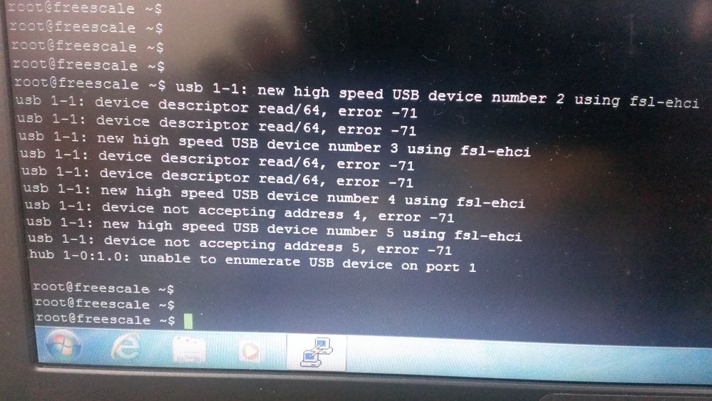

     I have a problem about usb mass storage driver, that's it can't enumerate my mass storage device.
     but it can enumerate my mouse, keyboard...etc hid device.
     anyone have idea about it ?
     I always get below messages when my mass storage device plugs in.

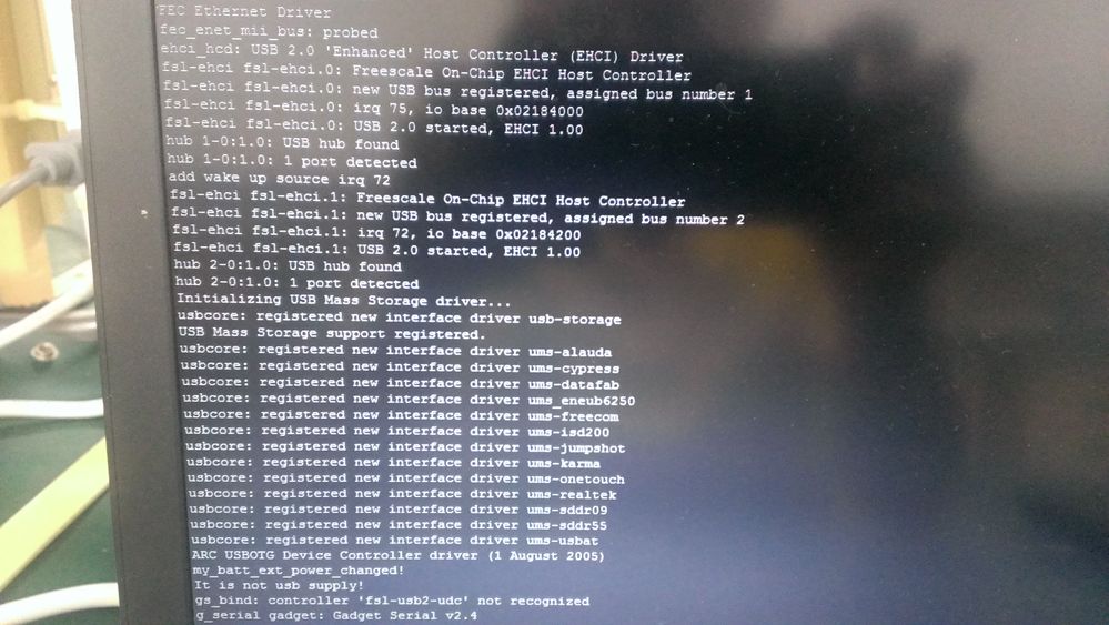

     and below is my dmesg information
     My hardware -->
     Type A receptacle on otg controller ~

Hi, I'm having the same issue, investigating now.  Have you made any progress or have a solution?
I'm not using the OTG port, but I am getting similar messages.
Hi Ken,
My issue had been fixed…but I didn’t do anything, that’s HW issue.

Maybe the difference between mass storage and HID devices is the speed.
Is this a custom board? Then check the layout and routing of the USB differential data lines.
Also, do you supply the USB PHY of the i.MX6 properly?
