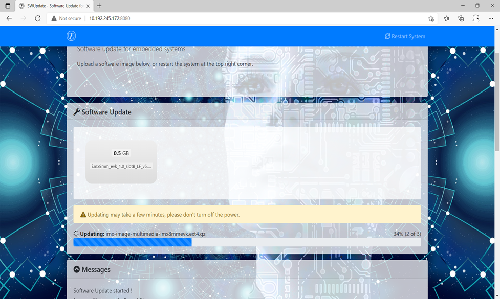

Mongoose daemon mode:
Mongoose is a daemon mode of SWUpdate that provides a web server, web interface and web application.
Mongoose is running on the target board(i.MX8MM EVK/i.MX8QXP MEK).Using Web browser to access it.

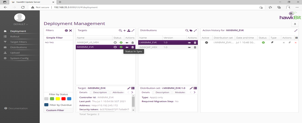

Suricatta daemon mode:
Suricatta regularly polls a remote server for updates, downloads, and installs them. Thereafter, it reboots the system and reports the update status to the server.
The screenshot is SWUpdate scuricatta working with hawkbit server.
