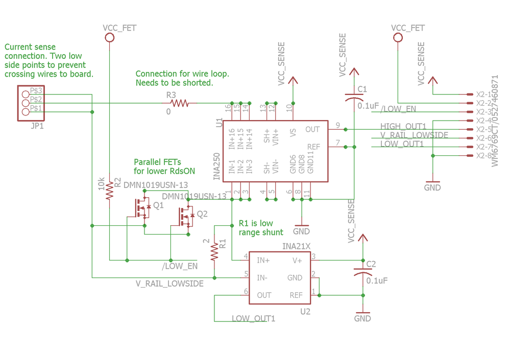

Circuit Description:
The INA250 + INA21x Sensor board can measure two ranges using the INA250 and INA21x current sense amplifiers. The high range is measured with an INA250, which has an integrated 0.002 Ohm shunt, and is available in four output gains. The low range is measured with shunt R1 and the INA21x sense amp. The low range shunt is taken out of the circuit (by shorting it) with two paralleled, very low-Rds(on) FETs, Q1 and Q1. VCC_SENSE powers the two sense amplifiers. VCC_FET supplies the gate voltage on Q1 and Q2. The DMN1019 device has a Vgs max of 8V. The sources of both FETs are tied to the i.MX side of the current sense loop, so the gate voltage Q1 and Q2 see is VCC_FET-(rail voltage). The signal /LOW_EN controls the state of both Q1 and Q2. The sense amplifier outputs (HIGH_OUT1 and LOW_OUT1) and rail voltage (V_RAIL_MEASURE) are sent down the ribbon cable (X2) to the profiler board for measurement. When not used for a wire loop for a Hall-effect current probe, resistor R3 should be shorted with a solder bridge, a piece of wire, or a 0.001 Ohm resistor.

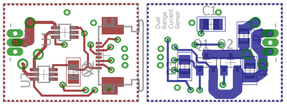

Board Layout:
The two large vias by the current sense connection points are provided for use with a 0.1" header and jumper to short the low range shunt, allowing normal operation of the target board when the profiler is not powered. It should be noted a jumper will not be as effective for relatively large currents.

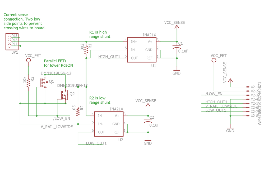

The Dual INA21x Sensor board can measure two ranges using two INA21x current sense amplifiers and two different shunts. The high range shunt (R1) is always in place. The low range shunt is taken out of the circuit (by shorting it) with two paralleled, very low-Rds(on) FETs, Q1 and Q1. VCC_SENSE powers the two sense amplifiers. VCC_FET supplies the gate voltage on Q1 and Q2. The DMN1019 device has a Vgs max of 8V. The sources of both FETs are tied to the i.MX side of the current sense loop, so the gate voltage Q1 and Q2 see is VCC_FET-(rail voltage). The signal /LOW_EN controls the state of both Q1 and Q2. The sense amplifier outputs (HIGH_OUT1 and LOW_OUT1) and rail voltage (V_RAIL_MEASURE) are sent down the ribbon cable (X2) to the profiler board for measurement.

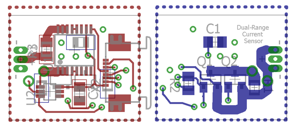

Board Layout:

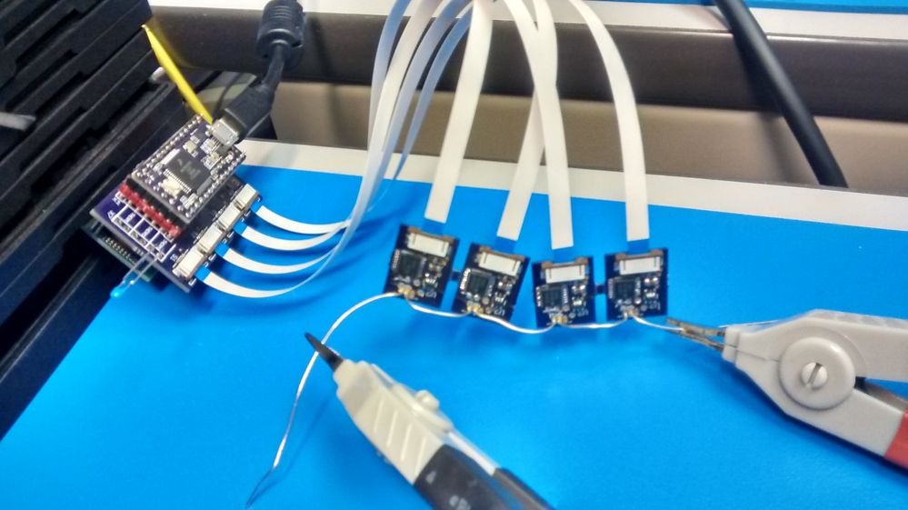

To test the boards after assembly, check for the presence of 8V on the pull-up resistors R5-R8 when a USB cable is plugged into the Teensy. Program the Teensy with suitable application code. Connect the sensor boards to the profiler. Connect all the sensor boards together in series, positive of one to negative of the next and connect to a calibrated current source. (The image below shows an early prototype of the profiler with the sensor boards connected in series. Current is forced through them via the Kelvin contact clips.)
sensorsinseries.jpg Open a terminal window on the host computer. Force known currents and toggle the ranges of each sensor to verify that each sensor operates correctly in both ranges.
To check that the profiler measures rail voltage correctly, disconnect the current source and apply the positive side of a voltage source to either side of the sensors still connected in series and connect the ground of the voltage source to a ground point on the profiler. The rail voltage measured by each sensor should match the supplied voltage (0 to 3.3V max).

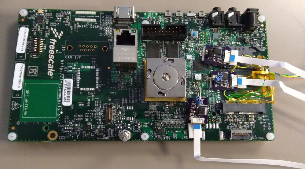

Instrumenting Target Board:

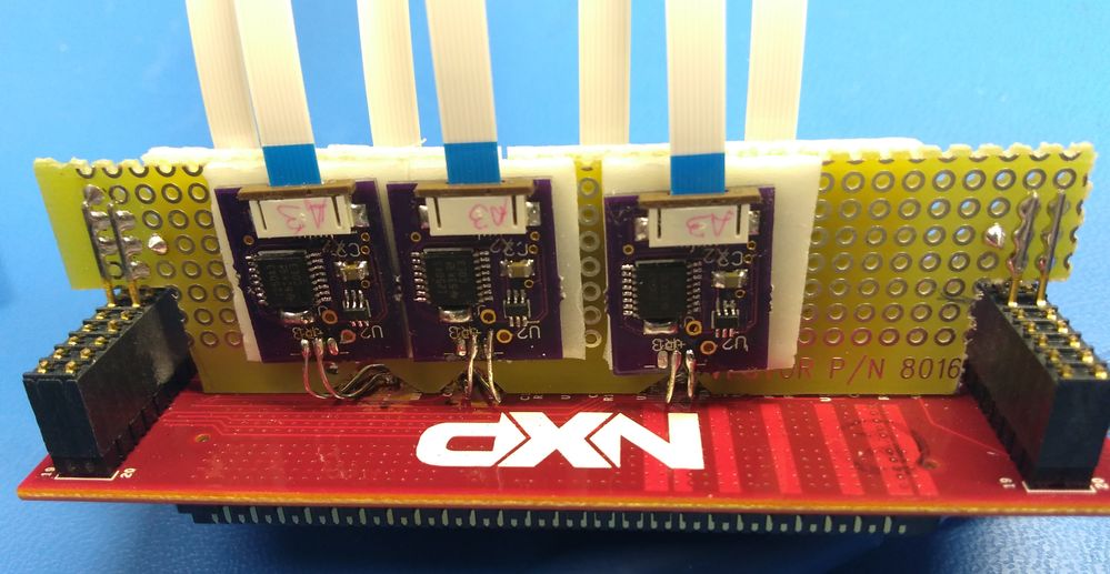

When instrumenting a target board, the on-board current sense resistor should be removed. The sensor board should be attached to the target board placed as close as possible to the sense resistor pads. Connection wires to the sensor board should be as short as possible to minimize series resistance. Great care should be taken to prevent movement of the sensor boards that could in turn lift the sense resistor pads off the target board. Foam double sticky tape should be used over clear areas of the target board to avoid dislodging components when the tape is removed.

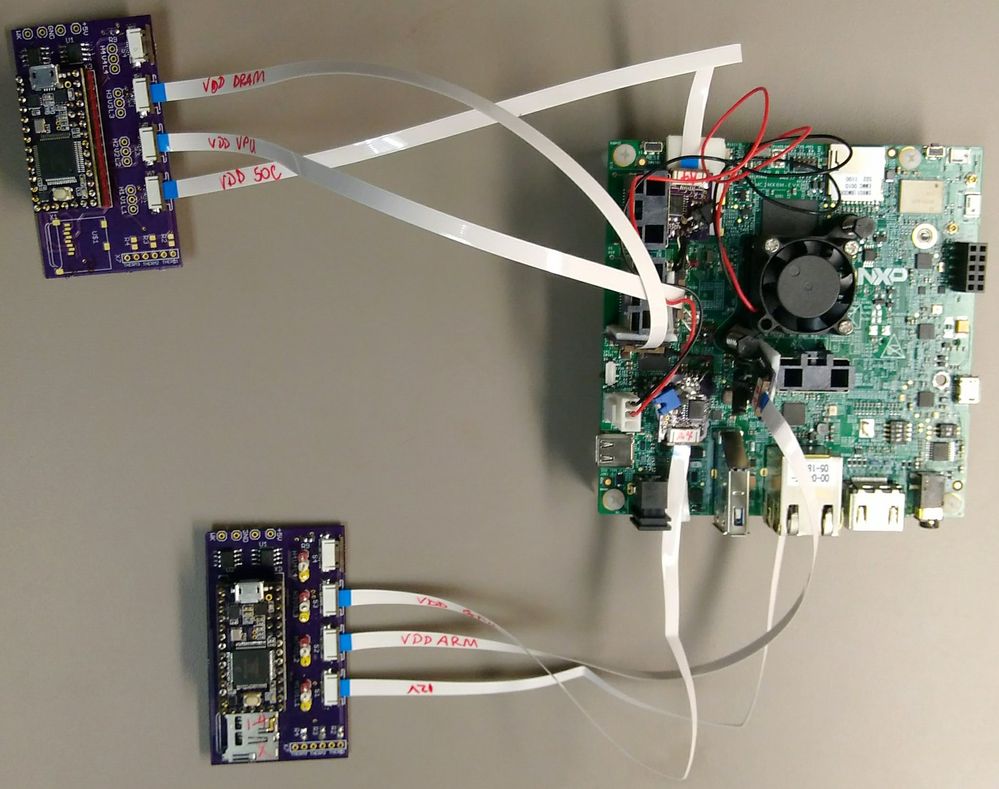

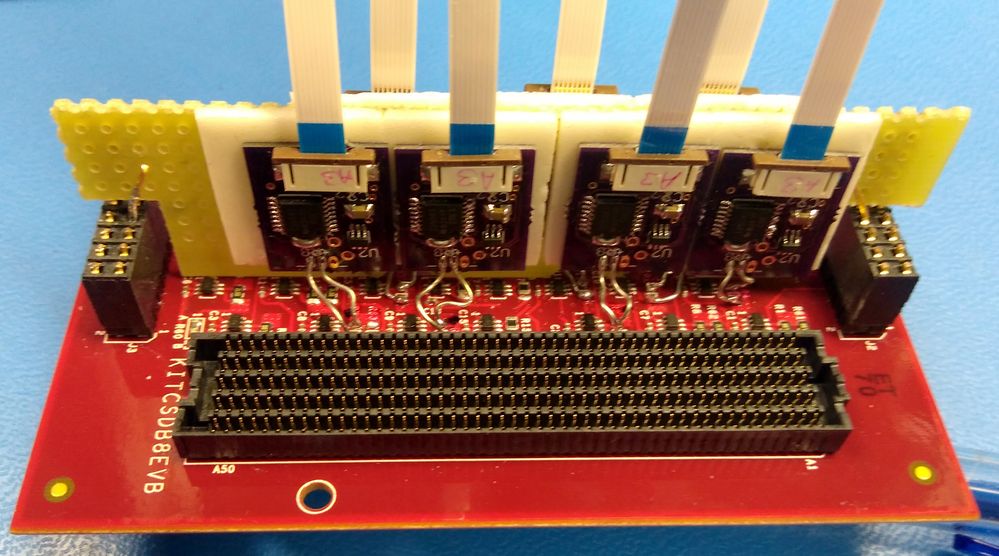

In the photos below, seven power supplies are instrumented on an interposer card. In this example, the sensor boards were affixed to perf board held in place by the headers. Because of the physical constraints of the target board and its power supply card, mounting the sensor boards directly to the interposer was not possible. Four sensors were mounted on one side and three on the other. Notches were cut in the perf board for the sensor's connection wires on the opposite side. Two profiler boards are required for simultaneous use. (Two were also required because the 0.1" headers and jumpers were not installed on the sensor boards to passively short the low-range shunts; all the sensor boards need to be powered to actively short the low-range shunts.)
The positive input of the sensor board (the center of the three connection points) goes to the regulator side of the current sense resistor. The negative input (either of the two outside connections) goes to the i.MX side of the sense resistor.
[NOTE: In this example, the power profiler boards have not been fully populated: the thermistor-related components and the micro-SD card socket. The sensor boards were fully populated with the exception of the passive shorting jumper.]

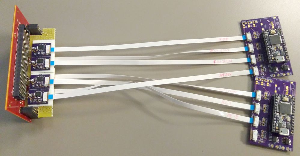

Here is another example of a board with six instrumented rails. The sensors in this case are mounted directly on the target board. In this example, the 12V rail is instrumented, which required modding to add a voltage divider to V_RAIL_LOWSIDE on that sensor board.
And here's yet another example of an instrumented i.MX6Q SDB (which still has wires on it from measuring it the old way...). Although it's difficult to see in this photo, all of the sensor boards have a jumper across the low range shunt which permits normal operation of the board without the profiler board attached to provide power to the shorting FETs.
