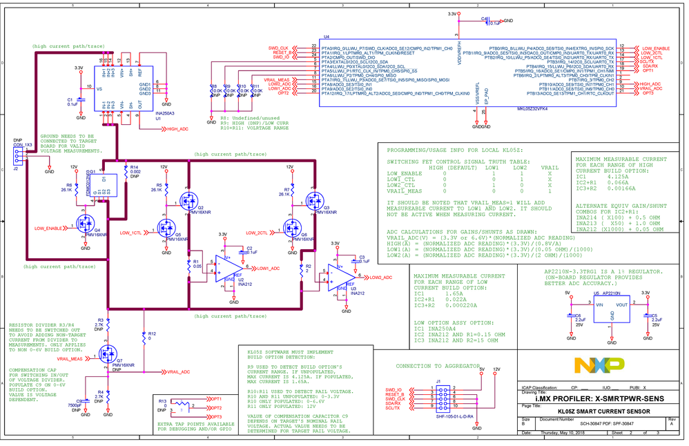

Schematic:

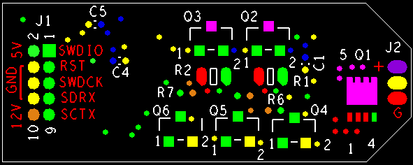

Board Layout, Top:

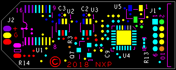

Board Layout, Bottom:

Connections:
The smart sensor header connections are:
  • 5V: powers the 3.3V regulator, which in turn powers everything else on the sensor board
  • 12V: all the gates of all the switching FETs are pulled pulled up to 12V
  • GND: ground connection
  • SCL/TX: I2C clock line
  • SDA/RX: I2C data line
  • SWD_CLK:  line for triggering smart sensors to make measurements
  • RESET_B:  line for resetting the smart sensor board
  • SWD_IO: select line for the smart sensor
Theory of operation:
Three shunts and current sense amplifiers are used to measure current in three ranges. One shunt/sense amp pair has a 0.002Ω shunt integrated into the IC package (U1, INA250). The other two sense amps (U2 and U3, INA212) require an external shunt.
FETs Q1, Q2,  and Q3 are used to switch the two lower range shunt/sense amp pairs in and out of circuit. In normal run operation (highest current range), Q1 (FDMC012N03, with Rds(on) under 1.5mΩ) is turned on, which shorts leaves only U1 in circuit. FETs Q4, Q5 and Q6 translate the voltages to 3.3V so that GPIO on U4 (MCU KL05Z) can control them.
Rail voltage measurement is facilitated via resistors R3, R4, and R12 and Q7. Not all of these are populated in every assembly option. For measuring rail voltages 0-3.3V, R12 is populated. To measure 0-6.6V, R3, R4,and Q7 are populated. When turned on Q7 enables the voltage divider. All of the assembly option population info can be found in the schematic (attached).
Regulator U5 (AP2210N) provides the 3.3V supply for all of the components on the board. This 1% tolerance regulator is used to provide a good reference for the ADC in U4.
Microcontroller U4 detects the assembly population option of the board via resistors R9, R10, and R11 so that the same application code can be used across all variations of the sensor boards. GPIO control the FETs and four ADC channels are used to measure the sense amplifier outputs and the rail voltage. Having a microcontroller on the sensor board allows the user to do extra credit things like count coulombs as well as allowing all similarly instrumented rails to measure at the same time via trigger line SWD_CLK. Data communication can be via I2C or UART, since these two pins can do both.  But if multiple sensor boards are to be used with an aggregator, communication needs to be over I2C.
