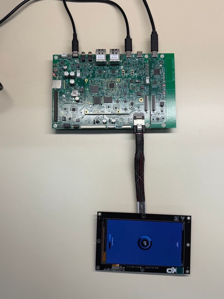

HW set-up
  • i.MX 93 EVK boot over eMMC/uSD to Linux Factory or Ubuntu.
  • Connect power and debug receptables.
  • Connect MX8_DSI_OLED1 to J701 (MIPI DSI) through MiniSAS cable.

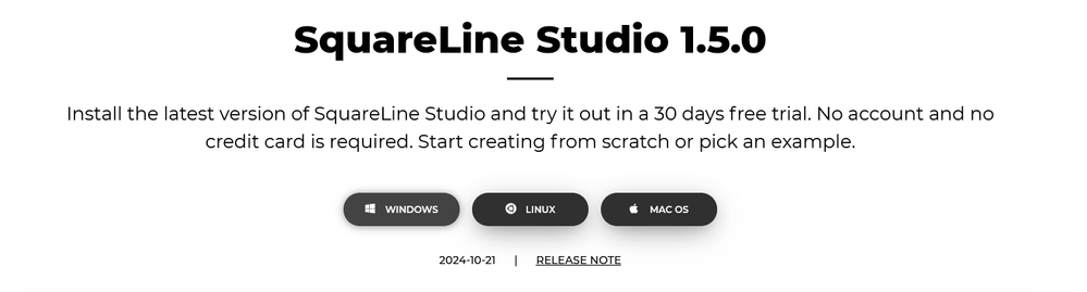

Download the latest version of SquareLine under the following link according to your host system.
NOTE: This document is intended for demonstration of templates included within the tool, so it's recommended to download a free trial, for formal development please refer to the appendix of this document.

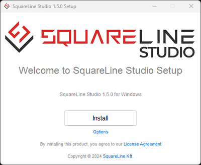

Unzip and execute the installer, this is the windows prompt.

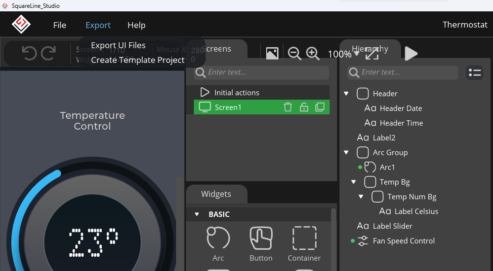

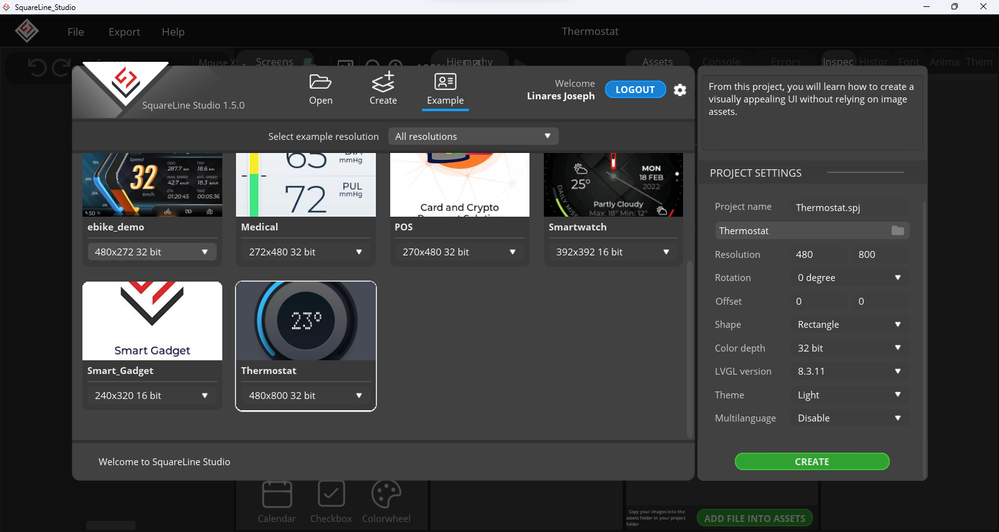

After setting SquareLine up go to the example section, we will demonstrate the thermostat capabilities with the Thermostat Demo.
We can directly export these UI files and they would be graphically ready to be build, click on Export -> Export UI Files and select your preferred destination to save these.
