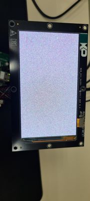

2. Write random data on the frame buffer with the next command:
$ cat /dev/urandom > /dev/fb0
You should see colored pixels on the screen

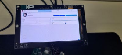

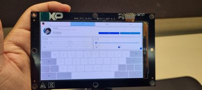

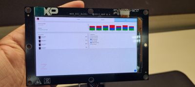

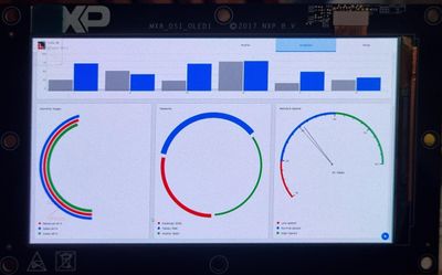

4. Share the file called "demo" with your board and execute it on the board with the command
$ ./demo
Note: You have to stop the weston service to run the application.

Notes:
Tested on iMX8MN EVK with BSP 6.1.36
Works on Multimedia and Full image.
