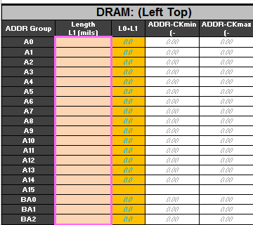

I'm trying to use this check list for my design and the data bus in the "MX6 DRAM Bus Length Check" tab fails because of the L0 values for DRAM_D48 to DRAM_D63 are filled with values over 300.  That seems a lot, considering that all the other pins are set to 0.   Are the L0 values set up correctly in the spreadsheet? Our layout is almost identical to the Freescale reference platform.
Hi Rowlan,
Thanks for your comments!
It is a bug, I had fixed it and updated.
All L0 should be zero in the excel.

The DRAM lenght tab is interresting but why keep all L0 to 0 ?
I got the internal wiring length for both PBGA and FCBGA and they do vary, I think we should take this inyo account and have a tab for each package and maybe increase tolerance to match Hardware Development Guide.
Thanks, Philippe.
Yes,you catch the point.
That's the reason why we define a very strict equal length rules.
Based on simulation analysis and real test result, the rules are robust to meet the requirement using PBGA and FCBGA on same PCB design.
We believe most of our customer don't care L0 but only the stability and performance.

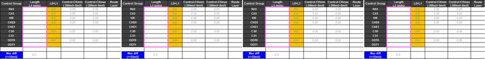

  I refer to "HW Design Checking List for i.Mx6DQSDL Rev2.7" for DRAM Bus length Check of my layout, but I found control group should only have CKE/CS/ODT, cannot include RAS/CAS/WE, I also refer to Intel and "IMX6DQ6SDLHDG_Hardware Development Guide" that the documents also describe Control signals only have CS/CKE/ODT, why does control group include RAS/CAS/WE in the "HW Design Checking List for i.Mx6DQSDL Rev2.7" and compare the trace length<=25mil?
Jasper Chen.
Hi Jasper,
Please check checking list and HDG carefully, we list RAS/CAS/WE in another row of table.
trace length rules are defined for timing control.
Hi LinWang:
I check it carefully, that's why I can find the different between HDG and HW design checking list of Freescale documents, so Freescale any recommend for the different? follow HDG or checking list?
Thanks and best regards,
Jasper.
Hi Jasper,
Sorry, would you please capture a picture and show the different to me?
I believe it is same between checking list and HDG on this part.
Thanks!

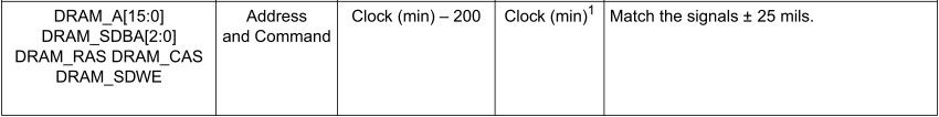

Hi LinWang:
     Please see "Hardware Develop Guide for i.MX6Dual/6Quad and i.MX 6Solo/6DualLite Applications Precessors, Rev. 1" page3-8 Table3-3. DDR3 routing by byte group as below Pic1/2.
Pic1.
Pic2.
Pic3. from HW Design Checking List for i.Mx6DQSDL Rev2.7: MX6 DRAM Bus Length Check.
Jasper.
Hi Jasper,
If you mean CS1/ODT1/CKE1, the reason is most application only use one CS, so the self checking table didn't include another CS related signals.
If you will use two CS, all signals should follow the rule.
if you mean Address and BA, you can find them in the top side of table.
Hi LinWang:
I mean RAS/CAS/WE should compare with Address signals and not compare with control group whatever CS[0:1]/ODT[0:1]/CKE[0:1] from Intel and Freescale HDG.
But why RAS/CAS/WE signal compare with control group in the checking list?
Jasper.
Hi Jasper,
All address and control signals should compare with clock length.
it is aligned in table and excel.
Please check.

Hi LinWang,
     But HDG describe RAS/CAS/WE should compare with clock and address signals, not control signal(CKE/CS/ODT).
Why?
Please confirm again~
I can't understand why you say HDG " describe RAS/CAS/WE should compare with clock and address signals".
all signals are compare with clock in HDG and checking list.
Hi LinWang,
  Please just focus on command and control signals.
The HDG recommend command signals compare with clock and address signals.
But the checking list recommend command signals compare with control and clock signals, not compare with address and clock signals.
The two documents description is different, please check~

Hi LinWang,
My question is
In the HDG define: Command signals(RAS/CAS/WE) compare with "address signals" and clock signals.
In the MX6 DRAM Bus Length Check sheet of HW Design checking list define: Command signals(RAS/CAS/WE) compare with "control signals" and clock signals.
Which one is correct?
