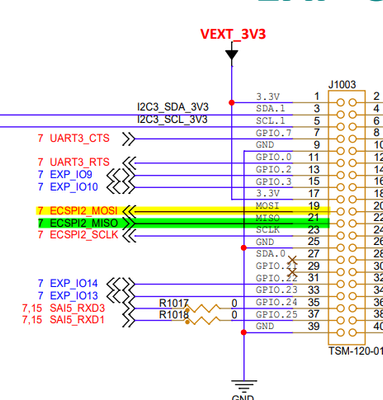

In this example I will use GPIO5_IO12 (ECSPI2_MISO) as Input with IRQ and GPIO5_IO11 (ECSPI_MOSI) as Output of IMX8MM-EVK. I will connect the Output to the Input and will see the behavior of the IRQ in Rising and Falling edge.
For this example I will connect ECSPI2_MOSI (GPIO5_IO11) to ECSPI_MISO (GPIO5_IO12):

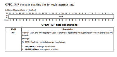

GPIO_PortEnableInterrupts refers to GPIOx_IMR:
