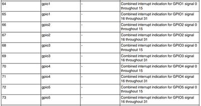

To use a GPIO as input with interrupt we need to keep in mind how the GPIO IRQs works in the ARM Cortex M4.
We can find in Table 7-2 (CM4 Interrupt Summary) of IMX8MMRM (IMX8MM Reference Manual) the GPIOs IRQs are divided by two parts:
  • Combined interrupt indication for GPIOn signal 0 throughout 15
  • Combined interrupt indication for GPIOn signal 16 throughout 31
This basically means, the pines of GPIOn from 0 to 15 are handled by Combined interrupt indication for GPIOn signal 0 throughout 15 and the pines from 16 to 31 are handled by Combined interrupt indication for GPIOn signal 16 throughout 31.
In SDK we can find these definitions in:
<SDK root>/devices/MIMX8MM6/MIMX8MM6_cm4.h (Remember this is for IM8MM SDK)
In this example I will use GPIO5_IO12 (ECSPI2_MISO) as Input with IRQ and GPIO5_IO11 (ECSPI_MOSI) as Output of IMX8MM-EVK. I will connect the Output to the Input and will see the behavior of the IRQ in Rising and Falling edge.

#define IN_IRQ
GPIO5_Combined_0_15_IRQn
This define the IRQ number (72 in this case)
