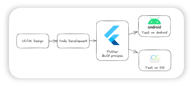

A basic Flutter development process based on my experience looks like the following diagram:

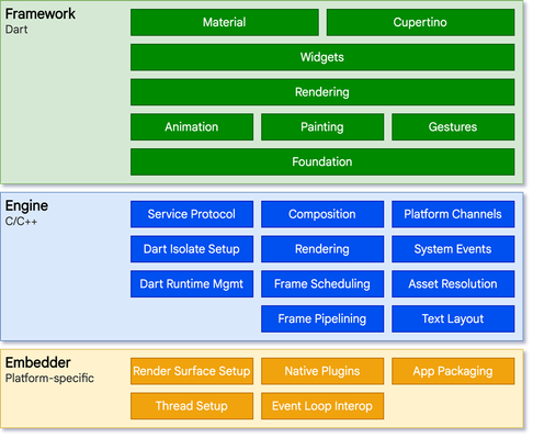

Based on the Flutter documentation the system is designed using layers that can be illustrated as follows:
Source: Flutter architectural overview | Flutter
We can see as a top level “Framework” which is a high-level layer that includes widgets, tools and libraries that are in contact with developers.
Below “Framework,” the layer “Engine” is responsible of drawing the widgets specified in the previous layer and provides the connection between high-level and low-level code. This layer is mostly written in C++ for this reason Flutter can achieve high performance running applications. Specifically for graphics rendering Flutter implements Impeller for iOS and Skia for the rest of platforms.
The bottom layer is “Embedder” which is specific for each target and operating system this layer allows Flutter application to run as a native app providing the access to interact with different services managed by the operating systems such as input, rendering surfaces and accessibility.

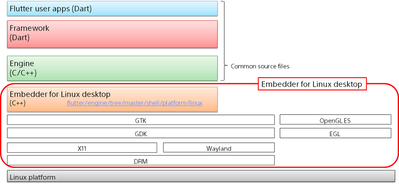

This layer for Linux Desktop uses GTK/GDK and X11 as backend that is highly dependent of unnecessary libraries and expensive for embedded systems which have constrained resources for computation and memory.

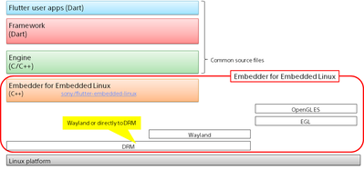

The work around founded by Sony’s Flutter for Embedded Linux repository is to change this backend using a widely implemented backend for embedded systems Wayland.
The following image illustrates the difference between Flutter for Linux Desktop and Flutter for Embedded Linux.
Source: What's the difference between Linux desktop and Embedded Linux · sony/flutter-embedded-linux Wiki · ...
Here is the link to the mentioned repository: GitHub - sony/flutter-elinux: Flutter tools for embedded Linux (eLinux)
