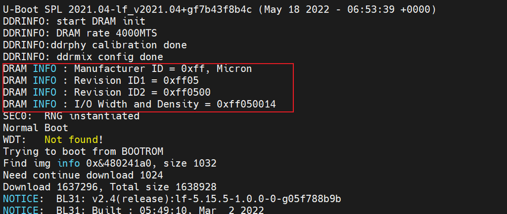

Background
The function lpddr4_mr_read in BSP always return zero and this casue the customer can't use it to read MR registers in DRAM.
This is a simple demo for reading MR registers.

Test Result
