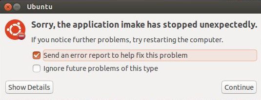

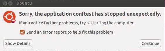

When compiling gstreamer, this warning was pop up.  Just ignore it seems okay.
