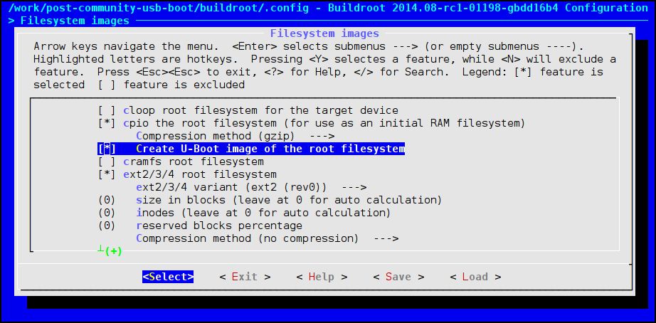

By default this would generate binaries suitable for booting with an SD card, so we need to tweak a few settings to obtain a ramdisk, which u-boot will like. Summon the configuration menu with the following command:
$ make menuconfig
Descend into the "Filesystem images" submenu, and select the following buildroot options:
- cpio the root filesystem (for use as an initial RAM filesystem)
- Compression method (gzip)
- Create U-Boot image of the root filesystem
Exit, saving your configuration. You might want to verify that you have indeed the the correct options in your .config:
$ grep '^BR2_TARGET_ROOTFS_CPIO' .config
This should return the following:
BR2_TARGET_ROOTFS_CPIO=y
BR2_TARGET_ROOTFS_CPIO_GZIP=y
BR2_TARGET_ROOTFS_CPIO_UIMAGE=y
