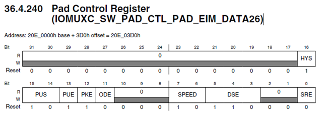

    • Add the pinctrl configurations for the nodes you want to add. UART2_TXD and UART2_RXD are the pins used for the serial debug console. The pin description must be placed in the iomuxc node.
&iomuxc{
     imx6q-udoo{
          pinctrl_uart2: uart2grp{
               fsl,pins = <
                         MX6QDL_PAD_EIM_D26__UART2_TX_DATA          0x1b0b1
                         MX6QDL_PAD_EIM_D27__UART2_RX_DATA          0x1b0b1

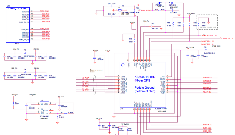

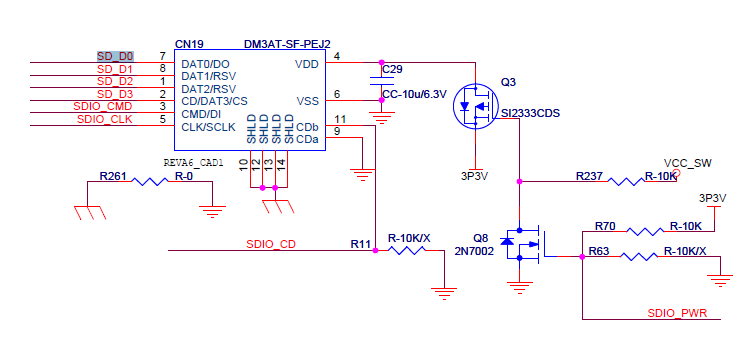

    • The RGMII connection and SD characteristics are the same as iMX6Q SABRE-SD .
pinctrl_usdhc3: usdhc3grp {
                        fsl,pins = <
                               MX6QDL_PAD_SD3_CMD__SD3_CMD 0x17059
                               MX6QDL_PAD_SD3_CLK__SD3_CLK 0x10059
                               MX6QDL_PAD_SD3_DAT0__SD3_DATA0 0x17059
                               MX6QDL_PAD_SD3_DAT1__SD3_DATA1 0x17059
                               MX6QDL_PAD_SD3_DAT2__SD3_DATA2 0x17059
                               MX6QDL_PAD_SD3_DAT3__SD3_DATA3 0x17059

                               MX6QDL_PAD_GPIO_16__ENET_REF_CLK 0x4001b0a8

&usdhc3 {
        pinctrl-names = "default";
        pinctrl-0 = <&pinctrl_usdhc3>;
        non-removable;
        status = "okay";

                pinctrl_enet: enetgrp {
                        fsl,pins = <
                                MX6QDL_PAD_RGMII_RXC__RGMII_RXC         0x1b0b0
                                MX6QDL_PAD_RGMII_RD0__RGMII_RD0         0x1b0b0
                                MX6QDL_PAD_RGMII_RD1__RGMII_RD1         0x1b0b0
                                MX6QDL_PAD_RGMII_RD2__RGMII_RD2         0x1b0b0
                                MX6QDL_PAD_RGMII_RD3__RGMII_RD3         0x1b0b0
                                MX6QDL_PAD_RGMII_RX_CTL__RGMII_RX_CTL   0x1b0b0
                                MX6QDL_PAD_RGMII_TXC__RGMII_TXC         0x1b0b0
                                MX6QDL_PAD_RGMII_TD0__RGMII_TD0         0x1b0b0
                                MX6QDL_PAD_RGMII_TD1__RGMII_TD1         0x1b0b0
                                MX6QDL_PAD_RGMII_TD2__RGMII_TD2         0x1b0b0
                                MX6QDL_PAD_RGMII_TD3__RGMII_TD3         0x1b0b0
                                MX6QDL_PAD_RGMII_TX_CTL__RGMII_TX_CTL   0x1b0b0
                                MX6QDL_PAD_ENET_REF_CLK__ENET_TX_CLK    0x1b0b0
                                MX6QDL_PAD_ENET_MDIO__ENET_MDIO         0x1b0b0
                                MX6QDL_PAD_ENET_MDC__ENET_MDC           0x1b0b0

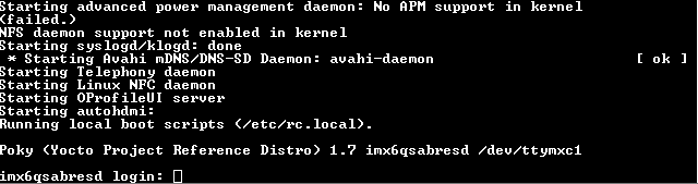

4. BOOTING THE IMAGE
After this you should have a simple and functional linux system. Just plug-in your SD card and power-up the board.
You should get an output in the serial console like the one below:
I hope you find this basic document helpful.
