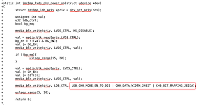

Hi @Wilson_S
1.The default lvds driver only enable one channel, you need add flags to enable another channel. Also need check pixel format in driver, the default setting is JEIDA format.
2.After enabling dual channel in LVDS_CTRL register, the clock is key point. You need add new PLL table to support dual channel panel. The default setting in patch is single channel PIXEL_CLK=74.25Mhz, so LDB_CLK_ROOT= PIXEL_CLK * 7, LDB_CLK_ROOT = VIDEO_PLL / 2
+		/* 519.75Mhz LVDS PLL ref from video PLL */
+		clock_set_target_val(MEDIA_LDB_CLK_ROOT, CLK_ROOT_ON | CLK_ROOT_SOURCE_SEL(7) |CLK_ROOT_POST_DIV(CLK_ROOT_POST_DIV2));
For dual channel, LDB_CLK_ROOT=PIXEL_CLK* 3.5, then you will get the VIDEO_PLL value :PIXEL_CLK*7.
For P,M,K,S value in PLL table, you can calculate them from formula in RM(CCM chapter).
-> I only find LDB_CH1_MODE_EN_TO_DI0 & LDB_CH1_MODE_EN_TO_DI1 but I could not find where to set this flag in the imx8mp_lvds.c and could you tell me how to enable the flag ? or provide a patch ?
Thanks!
Wilson
Hi @Wilson_S
This line:

The questions is that there is no data from the LVDS  port, I mean there are 4 data lines and 1 clk line on the LVDS cahnnel 0, the clk has 74M, data 0 and data 1 keep high, data 2 and data 3 has some data(I measured the results using an oscilloscope.).
I can confirm that the hardware is ok as the kernel can display LVDS well.
can you help check what happen?
We are using the NXP fsl-nxp-bsp-mickledore Yocto release that uses the NXP u-boot branch lf_v2023.04.
1. Are there any patches to support LVDS display of splash screen for this u-boot version ?
2. Is there some reason this support is not built into the NXP u-boot these days ?
