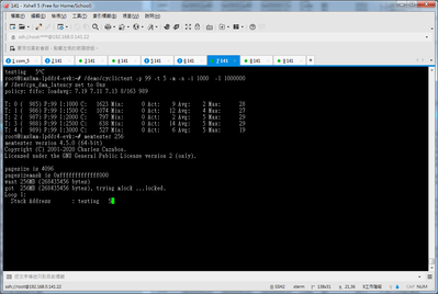

The following is test result by the command (/usr/xenomai/demo/cyclictest -p 99 -t 5 -m -n -i 1000 -l 100000
//Over normal Linux kernel without GPU SDK test case
T: 0 ( 4220) P:99 I:1000 C: 100000 Min: 7 Act: 10 Avg: 9 Max: 23
T: 1 ( 4221) P:99 I:1500 C: 66672 Min: 7 Act: 10 Avg: 10 Max: 20
T: 2 ( 4222) P:99 I:2000 C: 50001 Min: 7 Act: 12 Avg: 10 Max: 81
T: 3 ( 4223) P:99 I:2500 C: 39998 Min: 7 Act: 11 Avg: 10 Max: 29
T: 4 ( 4224) P:99 I:3000 C: 33330 Min: 7 Act: 13 Avg: 10 Max: 26
//Over normal Linux kernel with GPU SDK test case
T: 0 ( 4177) P:99 I:1000 C: 100000 Min: 7 Act: 10 Avg: 11 Max: 51
T: 1 ( 4178) P:99 I:1500 C: 66673 Min: 7 Act: 12 Avg: 10 Max: 35
T: 2 ( 4179) P:99 I:2000 C: 50002 Min: 7 Act: 12 Avg: 11 Max: 38
T: 3 ( 4180) P:99 I:2500 C: 39999 Min: 7 Act: 12 Avg: 11 Max: 42
T: 4 ( 4181) P:99 I:3000 C: 33330 Min: 7 Act: 12 Avg: 11 Max: 36
//Cobalt with stress-ng --cpu 4 --io 2 --vm 1 --vm-bytes 512M --timeout 600s --metrics-brief
T: 0 ( 4259) P:50 I:1000 C:3508590 Min: 0 Act: 0 Avg: 0 Max: 42
T: 1 ( 4260) P:50 I:1500 C:2338831 Min: 0 Act: 1 Avg: 0 Max: 36
T: 2 ( 4261) P:50 I:2000 C:1754123 Min: 0 Act: 1 Avg: 1 Max: 42
T: 3 ( 4262) P:50 I:2500 C:1403298 Min: 0 Act: 1 Avg: 1 Max: 45
T: 4 ( 4263) P:50 I:3000 C:1169415 Min: 0 Act: 1 Avg: 1 Max: 22
//Cobalt without GPU SDK test case
T: 0 ( 4230) P:50 I:1000 C: 100000 Min: 0 Act: 0 Avg: 0 Max: 4
T: 1 ( 4231) P:50 I:1500 C: 66676 Min: 0 Act: 1 Avg: 0 Max: 4
T: 2 ( 4232) P:50 I:2000 C: 50007 Min: 0 Act: 1 Avg: 0 Max: 8
T: 3 ( 4233) P:50 I:2500 C: 40005 Min: 0 Act: 1 Avg: 0 Max: 3
T: 4 ( 4234) P:50 I:3000 C: 33338 Min: 0 Act: 1 Avg: 0 Max: 5
//Cobalt with GPU SDK test case
T: 0 ( 4184) P:99 I:1000 C:37722968 Min: 0 Act: 1 Avg: 0 Max: 24
T: 1 ( 4185) P:99 I:1500 C:25148645 Min: 0 Act: 1 Avg: 0 Max: 33
T: 2 ( 4186) P:99 I:2000 C:18861483 Min: 0 Act: 1 Avg: 0 Max: 22
T: 3 ( 4187) P:99 I:2500 C:15089187 Min: 0 Act: 1 Avg: 0 Max: 23
T: 4 ( 4188) P:99 I:3000 C:12574322 Min: 0 Act: 1 Avg: 0 Max: 29
//Mercury without GPU SDK test case
T: 0 ( 4287) P:99 I:1000 C:1000000 Min: 6 Act: 7 Avg: 7 Max: 20
T: 1 ( 4288) P:99 I:1500 C: 666667 Min: 6 Act: 9 Avg: 7 Max: 17
T: 2 ( 4289) P:99 I:2000 C: 499994 Min: 6 Act: 8 Avg: 7 Max: 24
T: 3 ( 4290) P:99 I:2500 C: 399991 Min: 6 Act: 9 Avg: 7 Max: 19
T: 4 ( 4291) P:99 I:3000 C: 333322 Min: 6 Act: 8 Avg: 7 Max: 21
//Mercury with GPU SDK test case
T: 0 ( 4222) P:99 I:1000 C:1236790 Min: 6 Act: 7 Avg: 7 Max: 55
T: 1 ( 4223) P:99 I:1500 C: 824518 Min: 6 Act: 7 Avg: 7 Max: 44
T: 2 ( 4224) P:99 I:2000 C: 618382 Min: 6 Act: 8 Avg: 8 Max: 88
T: 3 ( 4225) P:99 I:2500 C: 494701 Min: 6 Act: 7 Avg: 8 Max: 49
T: 4 ( 4226) P:99 I:3000 C: 412247 Min: 6 Act: 7 Avg: 8 Max: 53

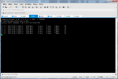

Latency testing of Xenomai3.2+Dovetail with isolating CPU 2,3 ( Xenomai 3.2 on 8MM DDR4 EVK with GPU test case (GLES2/S08_EnvironmentMappingRefraction_Wayland) + iperf3 + 2 ping 65000 size + stress-ng --cpu 2 --io 2 --vm 1 --vm-bytes 256M --metrics-brief )
The following is test result by the command (/usr/xenomai/demo/cyclictest -a 2,3 -p 50 -t 5 -m -n -i 1000)
root@imx8mmddr4evk:~# /usr/xenomai/demo/cyclictest -a 2,3 -p 50 -t 5 -m -n -i 1000
# /dev/cpu_dma_latency set to 0us
policy: fifo: loadavg: 5.96 6.04 6.03 7/155 1349
T: 0 ( 615) P:50 I:1000 C:63448632 Min: 0 Act: 0 Avg: 0 Max: 55
T: 1 ( 616) P:50 I:1500 C:42299087 Min: 0 Act: 0 Avg: 1 Max: 43
T: 2 ( 617) P:50 I:2000 C:31724315 Min: 0 Act: 0 Avg: 1 Max: 51
T: 3 ( 618) P:50 I:2500 C:25379452 Min: 0 Act: 0 Avg: 1 Max: 53
T: 4 ( 619) P:50 I:3000 C:21149543 Min: 0 Act: 0 Avg: 1 Max: 47

CPU isolation will help to improve the latency of Xenomai. Like:
1, Add isolcpus=2,3 in bootargs of uboot.
2, Run cyclictest with option -a 2,3

/demo/cyclictest -p 99 -t 5 -m -n -i 1000 -l 1000000
but i add
Have others encountered the same problem as me
hi @1234
Can you check your configuration XENOMAI_KERNEL_MODE ? And /sys/devices/system/cpu/cpu0/cpufreq/scaling_governor on your board?
how can i get my configuration XENOMAI_KERNEL_MODE
i jast know
0.611931] [Xenomai] scheduling class idle registered.
[ 0.614334] [Xenomai] scheduling class rt registered.
[ 0.619478] I-pipe: head domain Xenomai registered.
[ 0.626010] [Xenomai] Cobalt v3.1
Can I ask, have you ever tried usred memtester to do a stress test?
Thank you for your post.
