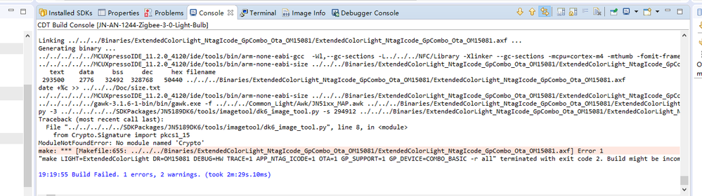

LChll
After I updated the latest routine, there was still a problem in the last step of compilation. Is this due to the unsuccessful installation of Python?M]XLK3F6SH]I6{15N_Q~$5R.png
