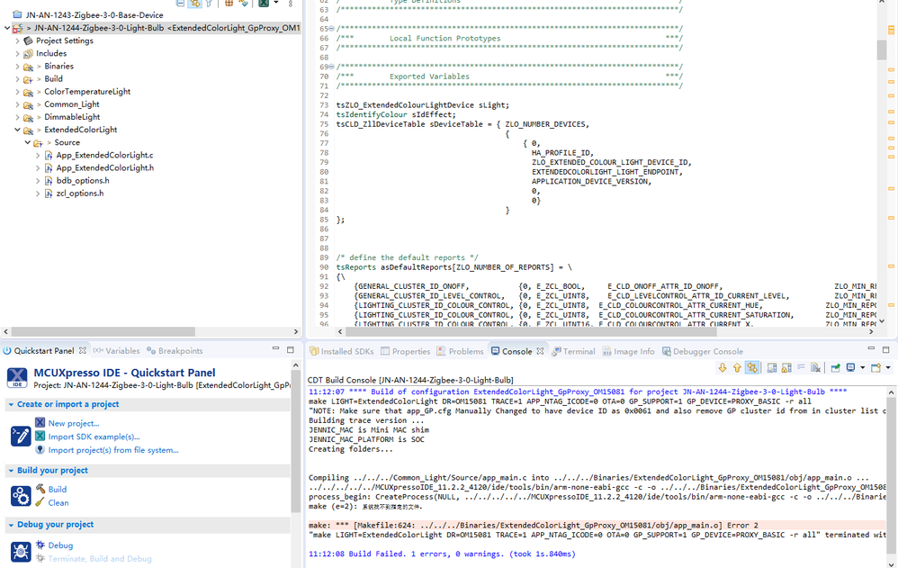

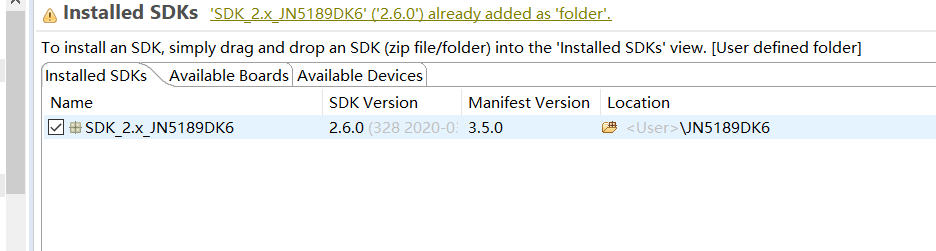

There are some issues with installing the JN5189 routines,My SDK does not match when importing the project, but I installed the 1260 documentation operation.Failed to compile.DRA}F@A(_$KL4DZXP5(UJ0Y.pngXOU03[4H3ZWB77QQK(SPDND.png

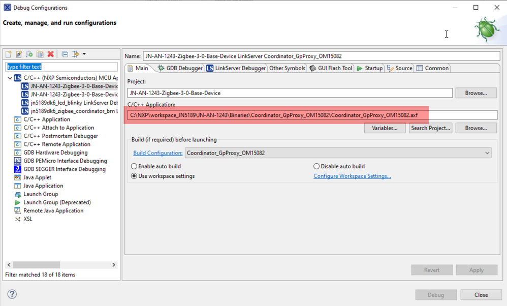

And finally, the compiled .axf file needs to be selected in the debug configuration:
Note: Be sure that the JP4 and JP7 are shorted as 3-4 on the board.

  • Installing the latest 2.6.1SDK also has this problem

After I updated the latest routine, there was still a problem in the last step of compilation. Is this due to the unsuccessful installation of Python?M]XLK3F6SH]I6{15N_Q~$5R.png
