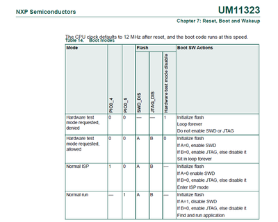

I'm starting a new product development using a K32W061 uC. And I'm pretty lost with the management of the Code Read Protection, boot, SWD, and ISP.
At the K32W061 there is the following table:
Reading this table, in the "Normal run2 mode:
I can't understand why these two diferent ways of describing SWD and the JTAG enabling fields. What happend if A=0? I suppose SWD is enable, but it makes me doubt. Is it possible SWD session in "Normal Mode (PIO0_5 high)" ?
Apart, unfortunetly I was not able to find how and where can I set these Flash fields SWD_DIS, and JTAG_DIS. On the other hand, Hardware Test Mode Enable is decribed on pFlash, together with ISP access level, but again I was not able to find a propper descrition of this pFlash and how to setup. The only description I found was on the section "38.7.6 Set ISP access level to write-only" using raw ISP. Does the DK6programmer have an easier support to setup the pFalsh?

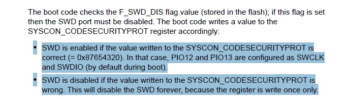

Finally, about the code read protection, the user manual mentions the following:
And in some SDK examples, I found the following code:
/* Board pin init */
/* Security code to allow debug access */
SYSCON->CODESECURITYPROT = 0x87654320;
but, also this other code on "startup_k32w061.c" using a LPC code read protection style. I guess this is a SDK bug:

So, I was not able to have a clear understanding of the managment of these subjects. Is there any appnote with a deeper explanation of all this things?

Hi Javier, I hope you're doing well!
I'm sorry for the inconvenience this may cause, but currently all of the information about CRP (Code Read Protection) that is available to share is the one found in the user manuals.
We are continuously working to provide more information about the modules in these new devices.
Just to clarify, in the case you describe, A = 0 will enable SWD. In normal circumstances without changes to SWD_DIS and JTAG_DIS, the device is able to be programmed using both SWD and JTAG.
Still, the DK6 programmer may be useful to provide control and setup for the flash on these devices.
Please let me know if you need any more information.
