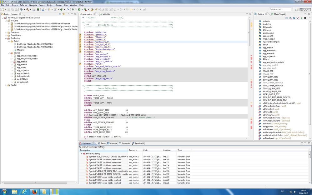

I'm new to developing ZigBee Applications and already get stuck with setting up the IDE. I have JN5168-M00 module and want to start programming with the JN-AN-1217-Zigbee-3-0-Base-Device Demo.
I installed the IDE as explained in JN-UG-3098 with BeyondStudio for NXP first, then the JN-SW-4170 Zigbee 3.0 SDK and installed the ZigBee Plugins. So far, so good.
After importing the Demo Project and trying to compile, I get a lot of symbol could not be resolved errors.Dependencies.jpg
To solve this problem I right clicked on the Project, chose Properties and then added the include files manually like shown in this picture:
Many Errors vanished, but some are still there as shown here
As I don't know if I'm on the right way to solve the Errors I want to ask here for some help.

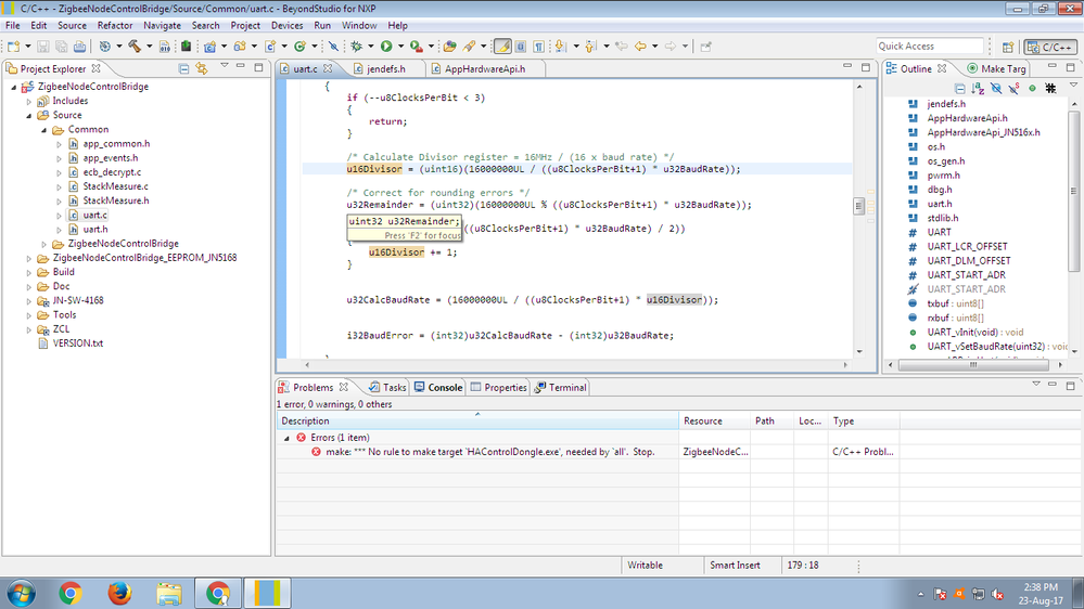

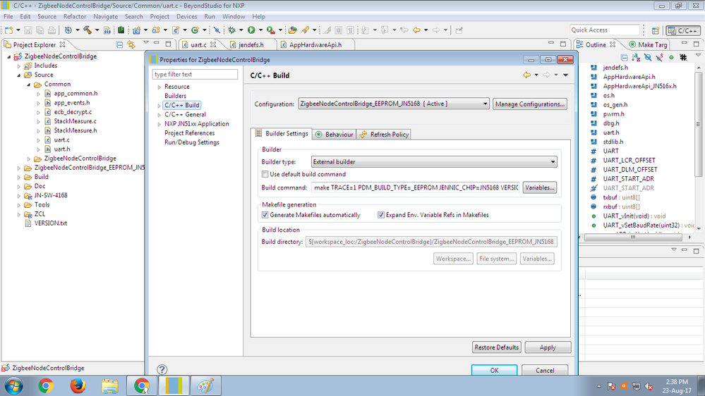

I'm new to developing ZigBee Applications. i have download JN-AN-1217-Zigbee-3-0-Base-Device Demo code , my proplem is when i built code any of i got error "make: *** No rule to make target `all'. Stop".
how to solve this please i tryed every thing but not solved this error.

dheerajsawant
Contributor V
Hello Mario Ignacio Castaneda Lopez,
Thank You for your time.
now i have resolve all issue and error.
i resolve those issue by installing SDK of 4168.
but last error is remaining. i have take screen shot please check it.
I think that issue is not regarding example/applicatoin, i think i am doing mistake in beyond studio setting.
please check screen shot and give me right direction.
Thank You for your reply and your time
Thank You very much
Dheeraj Sawant

dheerajsawant
Contributor V
i am trying to compile JN-AN-1162 application.
in that   Common -->Source-->uart.c
This application i am trying to compile.

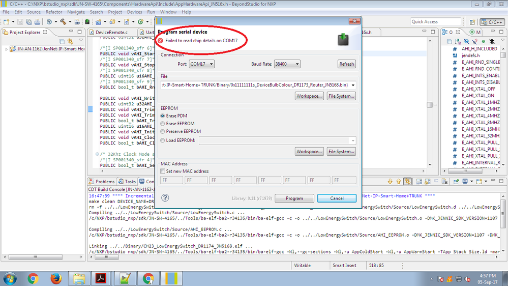

dheerajsawant
Contributor V
Hello mario_castaneda‌,
i am facing a problem .
not able to upload code in Jn5168 module.
i have attached screen shot showing error that "Failed to read chip details".
Connection is  "system--Moxa cable--interfacing board(RS232)--jn5168 Module board"

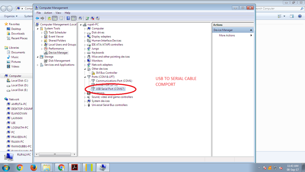

dheerajsawant
Contributor V
I think Beyond studio is not detecting Moxa cable which is usb to serial converter.
when i connect only moxa cable to system and try to check program device on Beyond studio then its started to show this error.
is there any solution?
Thank you for your time.

davidashraf
Contributor V
This error means either there's a problem in your connections to the module or a problem with USB driver
If you're sure of the drivers then check your connections
In programming mode The connection should be :
Tx -> Rx
Rx -> Tx
VDD -> 3.3v
GND -> 0v
SPIMISO -> GND
Notes:
-IF you're using another source of power other than USB then make sure both grounds are connected
-After making these connections reset the module by putting RESET pin -> GND then move it back to -> VDD
-Make Sure you're using UART0

dheerajsawant
Contributor V
Hello davidashraf‌,
yes connection is same as tx-rs and likewise.
Ground is common.
RESET pin -> GND then move it back to -> VDD ---its also done
using UART0(DIO9-10)pin of Jn5168 Module.
SPIMISO -> GND--------done
but still showing same error.

davidashraf
Contributor V
It's DIO6-7 not (DIO9-10)
please check it and try again and tell me

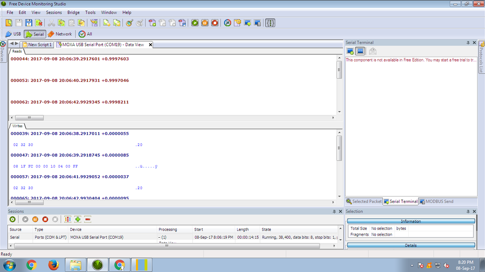

dheerajsawant
Contributor V
Hello davidashraf‌,
today i try something new. i tried to see data on Serial Port Monitor.
I download Serial Port Monitor Software and see below data.
this is information of Serial Port Monitor.
i am getting this read and write values while i am programming device.
i hope you understand.
how i do this:
1) i select com port and select "dataView" from available processing tab in serial port monitor.
2) and start process.
3)open beyond studio and program device and upload program and its failed as usually.
4)open Serial Port Monitor and see below data.
Really thanks for your time.
I hope you understand.
Thank you

dheerajsawant
Contributor V
Hello davidashraf‌,
Is there other tool to download binary code into JN5168 Module?
& why its Failed to read chip details on COMPORT?
Thank You
10,825 Views
dheerajsawant
Contributor V
Hello davidashraf‌,
I tried different different  baud rate.
Device manager:
Thank You
