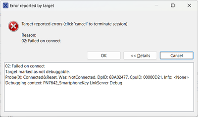

Hello!
I`m using PN7642EV/C101. On my custom board (I haven`t found DevKit for this version of IC) I can not enter debug mode. I`m using MCU Link to load and debug FW. During the connection sequence I have next log:

state - running or following reset request - re-read of state failed - rc Nn(05). Wire ACK Fault in DAP access
following reset read of core registers failed - Ep(08). Cannot access core regs when target running.
Target error from Commit Flash write: Ep(08). Cannot access core regs when target running.
GDB stub (C:\nxp\LinkServer_1.5.30\binaries\crt_emu_cm_redlink) terminating - GDB protocol problem: Pipe has been closed by GDB.

Hi Artem:
The error message is : Target marked as not debuggable.    I would suggest you refer to below link,  this issue was discussed.
02: Failed on connect: Ep(01). Target marked as not debuggable - NXP Community
you can try other debug probe, like MCU link pro.

Hi Daniel, thank you for response. I updated version of my MCU Link (not pro), anyway it is useful but unfortunately didn`t help. Another bad symptom is that when I configure debugger in such a way
and trying to to run debug sequence, I got this message:
Is there something you know can be the possible reason?
Thanks in advance!
Artem

danielchen
Are you using MCU Link pro?
I would suggest you update the firmware for the MCU LINK pro and try it again.
Getting Started with the MCU-Link Pro | NXP Semiconductors
