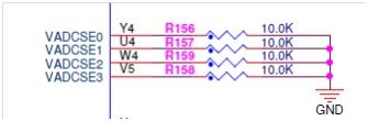

So, you are planning to connect and analog video signal to the Vybrid VideoADC input(s); there are several requirements to be met:
  • The analog video signal format should be supported by Vybrid. The regular NTSC or PAL composite video format (i.e. with “built-in” synchronization pulses) is one of the options  (refer to Reference Manual for more details).
  • The Vybrid VideoADC inputs should be available on the board in your possession; take into account that all the Tower board revisions currently available have all 4 of them wired to Ground, and I am afraid there is no easy way to use them.
But wait, there is a solution for that! - A new Tower board revision will be “offered to the public” within several weeks, on which these 4 pins will have pull-down resistors instead, i.e. will be accessible!

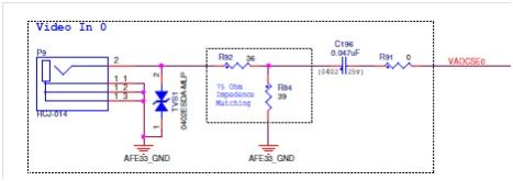

There already exists, though, another platform, Vybrid Automotive board, and it does have 4 RCA connectors tied to the Vybrid VideoADC inputs via an impedance matching (+ optional attenuation) circuit:

1. Do I need to use a external voltage divider as seen in schematic of the Auto-EVB (36 and 39Ohm) ?

1.       Do I need to use an external voltage divider as seen in schematic of the Auto-EVB (36 and 39 Ohm)?
·         I would recommend keeping this divider for the development stage but with changed values - 0 and 75 Ohms; if it works well with your specific camera type, you will be able to get rid of the 0-Ohms ones on the production stage.
