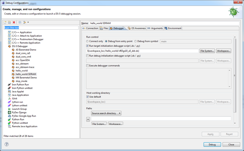

I have TWR-VF65GS10-PRO with DDR3 initialization problem in DS-5 with vf65gs10_a5_ddr.ds .
After vf65gs10_a5_ddr.ds is done, DDR3 still is not accessible.
Anybody has similar problem?

Hello Artsiom,
please ensure that SDRAM is correctly set prior to debug and it was successfully executed:
Using script attached (from Vybrid SC)
Or you can test new one with improved ZQ calibration.
/Jiri

artsiomstaliaro
Thank you. It works fine!
