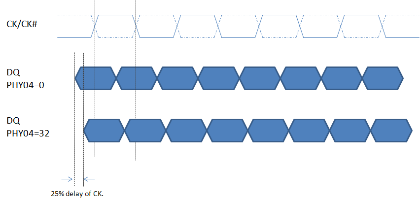

Dear support,
34.5.166 PHY Register 03 (DDRMC_PHY03)
34.5.167 PHY Register 04 (DDRMC_PHY04)
When I use DLL at Auto-configure mode, it is necessary to set this register?

Yes, that is correct but ENCODER is not the DLL_LOCK_VALUE
It is related to but not the same. Basically you don't need to worry about this ENCODER number. It is internal data and It should be transparent for you in auto-configure mode.
At the end you only need to tell what is the percentage of one-cycle delay you want.
So if you want 50% then DLL_WRITE_DL = 64  ===>  DLL_WRITE_DL/128 = 0.5
                      25% then  DLL_WRITE_DL = 32 ===> DLL_WRITE_DL/128 = 0.25

For Auto configure mode DDRMC_PHY03[DLL_START_POINT] you can set it to 0x04.
This value will be the starting point for the phase detector which will lock at a certain value called DLL_LOCK_VALUE which indicates the delay of one cycle.
The number of delay elements that are needed to capture an entire clock cycle is then converted into an unsigned integer named encoder [7:0]
Let say the period of 1 cycle is 100ms and encoder = 100.
Hence each delay element delays the signal 1ms and encoder = 100  which means that 100 delay elements are needed to delay the signal one complete cycle (100ms)
The actual delay setting for the delay lines is calculated by multiplying the encoder [7:0] integer by the parameter settings for each delay line and then dividing by 128 and rounding.
So if you want to delay the signal 25 ms, you need to set DDRMC_PHY04[DLL_WRITE_D] = 0x20 = 32
Numer of delay elemets DLL_WRITE_DL/128 * ENCODER =    32/128 * 100 = 25
This means internally 25 delay elements (of 1ms) will be used to delay the signal 25ms
In conclusion you still need to set DDRMC_PHY04[DLL_WRITE_D] to express the percentage (DLL_WRITE_D/128)  you want to delay the output signal

In auto configure mode, user set as following;
PHY03(DLL_START_POINT) should be set 0x04.
target delay is calculated as below;
PHY04_DLL_WRITE_DL/128 * ENCODER. (ENCODER is DLL_LOCK_VALUE)
Is it correct? Sorry, I could not understand which register is ENCODER...

juangutierrez

PHY04 can configure the how delay the data write from clock. if clock period is 10ns and would like to make 2.5ns delay (25%delay). user should set this register as 0x20.
If my understanding is not correct, could you correct it?
Best Regards
Taku.
3,453 Views
juangutierrez
Yes, that's correct
