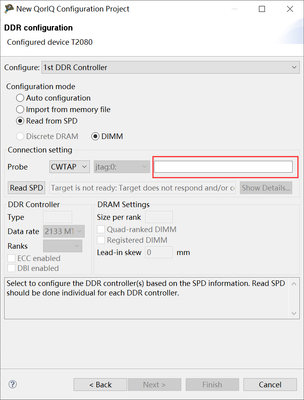

How to determine the value of the red box below。
1,750 Views
yipingwang
If you use CodeWarrior TAP Ethernet connection, please enter IP address of the CodeWarrior TAP.
If you use CodeWarrior TAP USB connection, no need to fill this box.
