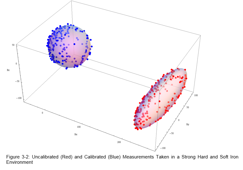

anthonyduhamel
Hi 大史,
You can have a look at the NXP Sensor Fusion​, we provide a full and open source project for electronic compass.
As the application is embedded in a car, you can NOT run the full 3D compass because you have 2 axis only.
The Sensor Fusion provides different algorithms for electronic compasses and IMUs. In your case, you can use the 2D Automotive Compass which needs a 2D calibration: instead of drawing a 8 it takes only a circle as you mentioned.

anthonyduhamel
大史,
If you want to understand the algorithm, I attached a document about magnetic calibration.
The algorithm is based on an ellipsoid (ellipse in 2D) recognition. When the ellipsoid parameters have been extracted, the algorithm transforms the scattershot  into a sphere (circle in 2D) with mathematical operations.
Anthony
