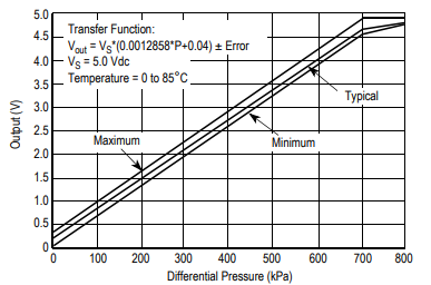

mpx5700dp output can use 5Voltage in datasheet but
i diagnose pin1(OUT) to only max 1Voltage  when i use pin3(5V),pin2(GND) without pin4,5,6

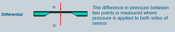

The MPX5700DP measures the difference between pressures applied simultaneously to opposite sides of the diaphragm:
The transfer function and characteristic:
