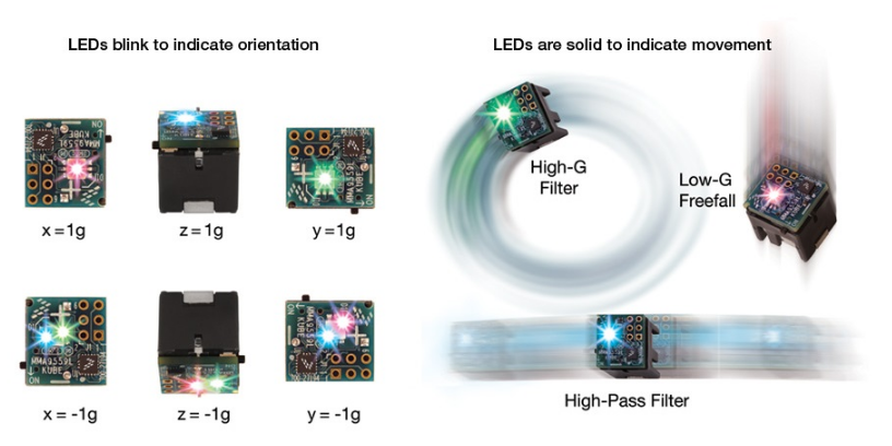

I saw the video with the MMA9559L cube accelerometer, where by tilting it, we get different colors. My question is whether I can purchase one or more of these such that:
(1) when the cube is not moving, the colors should be still, not blinking, and
(2) if it is possible to get a predefined color selection (no need to add new colors, just need to change the orientation order of the provided colors).

Hi Peter,
You can get more information on the MMA9559L Kube Demo at Accelerometer Kube Demo|NXP .
We provide the CodeWarrior project. So you would be able to customize with the color you want.
Please download the project and take a look at the kube.c file. This describes the high level operation of the Kube. As it is well commented, I suggest you to modify the section between line n°126 and the end of the file.
The picture below will help you to understand the basic functions of the MMA9559.
Have a good day!
Anthony
