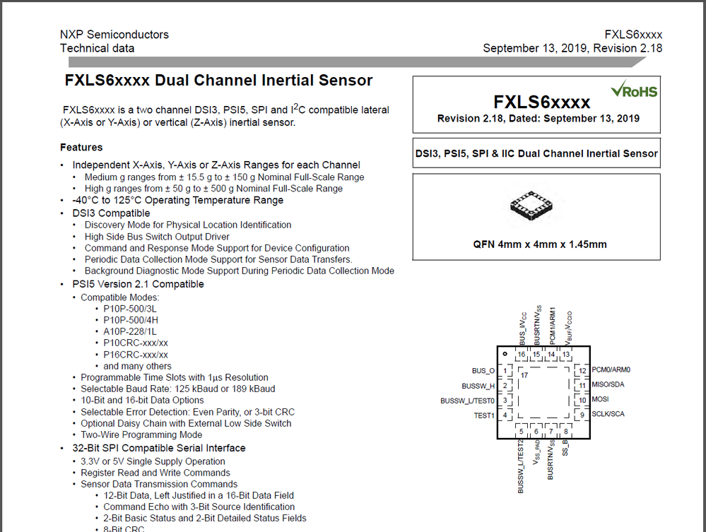

         In my datasheet, this table information of yours is not shown.At the same time, I need your help to confirm the maximum data rate of FXLS60322, the range and whether it can be adjustable.My version of the manual is shown in the picture.pastedImage_3.png

TomasVaverka
Hi Ren,
Please distinguish between the FXLS (Thornapple) and FXLSA (uThornapple) series. Both datasheet were sent to you internally by my colleague Jozef. Since your current question is related to the FXLS60322, please follow up on this through your Case #00274802.
