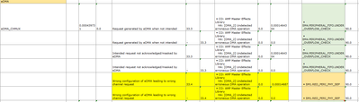

As below, it is captured from FMEDA for GPIO.
There are two safety mechanisms are placed as below:
• SM4.COMM_SAFEPROT
It was explained in Re: SM4.COMM_SAFEPROT - NXP Community
Thus, in case any communication is used via the GPIO the SM shall be used. Otherwise, it is not necessary.
• SM1.RED_PERI_PHY_SEP : This is rather for 99% DC. In case lower DC, it can be used for the same safety mechanism for the corresponding GPIO PIN? Also to use this safety mechanism, as example with input pins, the two external pins shall be used? Otherwise, without any HW configuration, it can be used?   How shall it be enabled?
Also, it is used for eDMA_CHMUX. How the SM cover the failure mode (Wrong configuration of eDMA leading to wrong channel request )? Is there any replacement in case the safety mechanism is not enabled?
The question is , if two of the SM are not used, the same mechanism can be applied for GPIO PIN, which the Integrator makes?

So, the safety mechanism "SM1.RED_PERI_PHY_SEP" is used when the physically separation of the two inputs in case redundant input is required for GPIO however, from FMEDA, the following is from eDMA.  In case more than two channels of eDMA are used, the safety mechanism  "SM1.RED_PERI_PHY_SEP" shall be enabled? It looks like it is physical separation of the pins. For example, it is related to ADC or some IO that the data is transferred to DMA. In this case, the failure modes can be covered by this mechanism? However, when it comes to SPI message, the safety mechanism still can cover?

Thus, to cover the failure modes marked in yellow below, the safety mechanism "SM1.RED_PERI_PHY_SEP" shall be enabled or not? Due to the answer such as  "Therefore this safety mechanism must not be enabled.", we need clarification. Should we enable or not enable?
